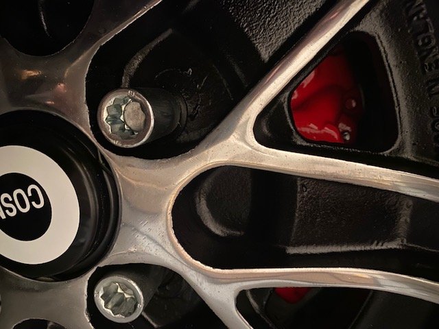

rogerguzzi Posted January 31, 2021 Posted January 31, 2021 Hello Ian I forgot to mention I do not think you can fit the full length studs to the rear hubs unless you remove the hub or drill a hole in the back plate! I think I shortened mine very slightly then you can just about wangle them in but still have enough threads for the nuts(well there is on my Minilites type wheels) Roger
Radioactive Man Posted January 31, 2021 Author Posted January 31, 2021 Yeah, the thought of pulling the rear hubs off doesn't make me excited... I need to do some careful measuring I think. I took 6mm off the length of the front studs. That gives me the full length of thread in the nut engaged and full insertion of the spline drive to tighten the nuts so I dont mind doing a little cutting as long as it make sense to do so.
rogerguzzi Posted January 31, 2021 Posted January 31, 2021 Hello Ian I can not remember how much but 6mm may be enough. I seem to remember there is one position with the brake shoes out and new studs at an angle you can just wiggle them in(I scrapped a couple until I got the right length!) I think I have a drive shaft with the hub and brake plate attached (given to me buy Nick and I have tried to get the hub off even with heat!)) so we or you or I could play with for best length ? Roger 1
rogerguzzi Posted February 1, 2021 Posted February 1, 2021 Hello Ian I had a measure of the spare shaft today I recon the longest you can fit without removing the hubs is 42 to 43mm overall length. The studs I have are 50mm overall. I recon when fitted it would give you 12 to 13mm plain and 17to 18mm thread. Which gives about 10 to 11 threads(turns of the nut.) The old stud is 35mm overall and a new one I have is 38mm overall. You could just drill a hole in the back plate and fit a grommet to seal the hole or borrow the hub puller? Roger
Radioactive Man Posted February 1, 2021 Author Posted February 1, 2021 Hi Roger, the studs I bought for the front measured in at 50mm so similar length and I took 6mm off to give the max engagement of the spline tool inside the nut. If I was taking 7mm or so off the studs for the back wheels that's still fine I think as its similar to the front. The overall threaded length inside the nuts is about 24mm.
rogerguzzi Posted February 1, 2021 Posted February 1, 2021 Hello Ian It looks like it will ok and will still be X times stronger than the 3/8" ones Roger

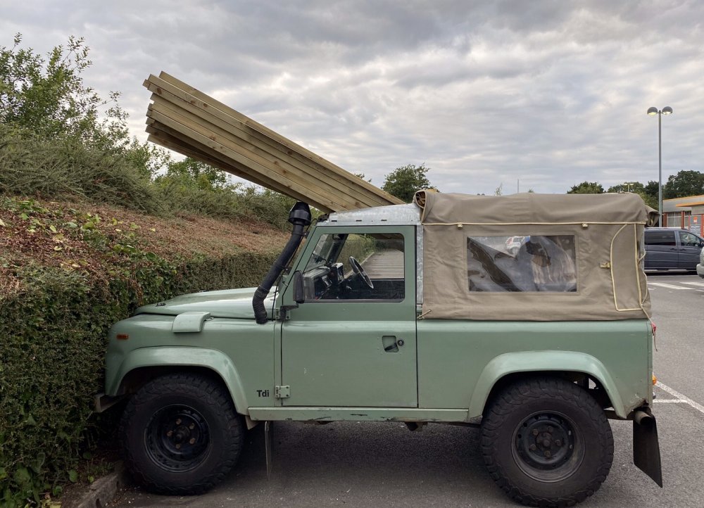

Radioactive Man Posted February 7, 2021 Author Posted February 7, 2021 Zetecsit reminded me of turning a land rover into a very top heavy Land Rover. Not sure what the weight was but it wasnt a great idea - very challenging round islands but I think a coffee table in a Spitfire is an equally special effort. 1

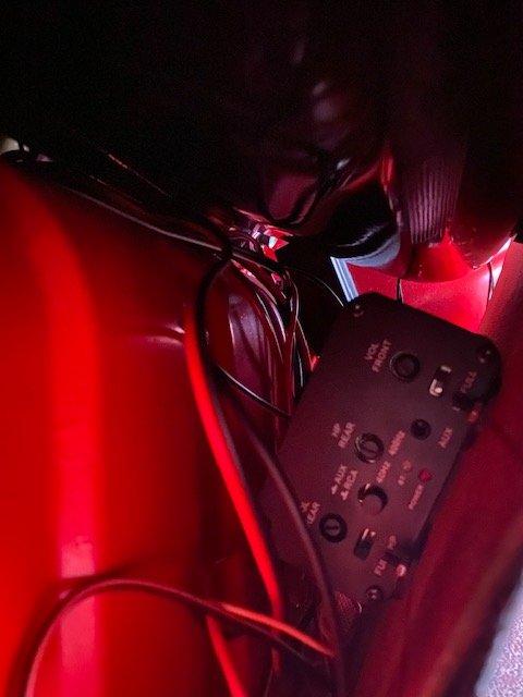

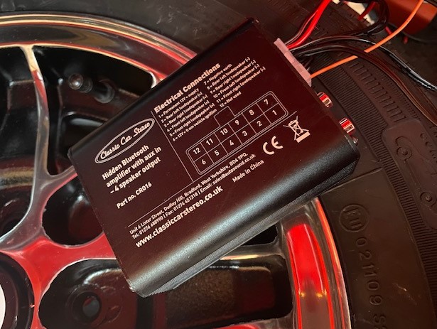

Radioactive Man Posted February 21, 2021 Author Posted February 21, 2021 in the pursuit of keeping a teeanger happy I added a hidden bluetooth amp in the boot and wired up four small speakers as apparently a sharp radio /cassette from 1976 wasnt cutting the mustard. Hidden behind the trim panel in the boot. Works really well. Spotify and the Spitfire are now friends... Anything for a quiet life :)
Nick Jones Posted February 21, 2021 Posted February 21, 2021 That’s a neat gadget. I may have to copy you for the GT6 entertainment system.
Radioactive Man Posted February 21, 2021 Author Posted February 21, 2021 Seams to work pretty well tucked up by the fuel tank. Bluetooth to the phone seems fine. Left the old stereo in place as a decoy and nod to the old pre Bluetooth days.
Escadrille Ecosse Posted February 21, 2021 Posted February 21, 2021 I like that. Was wondering what they were like as I was thinking along the same lines for the Spitfire. Think that sold it for me.

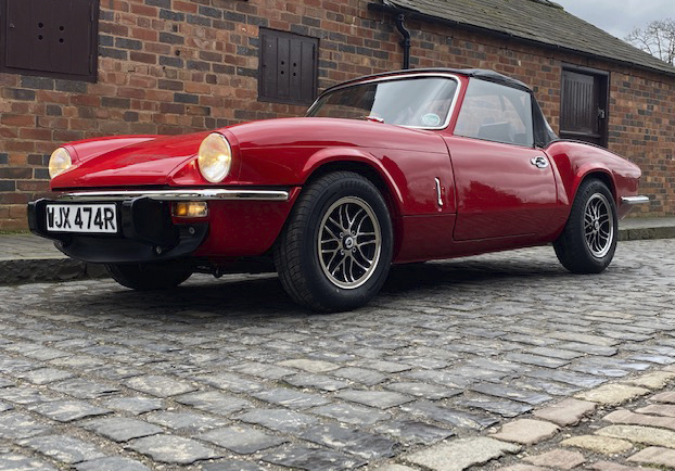

Radioactive Man Posted February 25, 2021 Author Posted February 25, 2021 Scary how small old cars are. Had to actually go to the office today so an excuse to get the Spit out.
