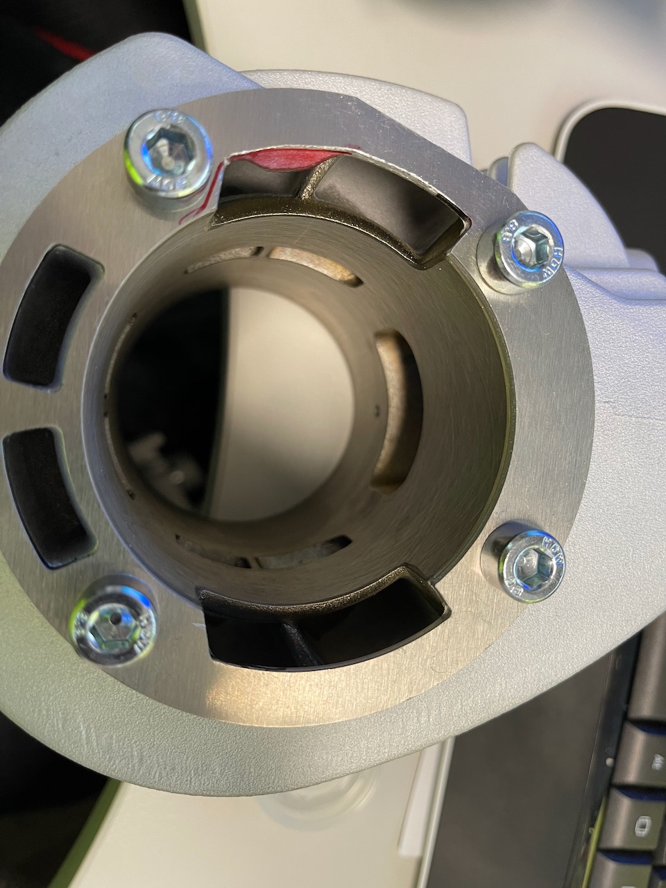

GT6MK3 Posted May 19, 2021 Author Posted May 19, 2021 There's been a slowly growing collection of parts for the Minnow's next power plant. his one will be built with modern go fast bits to give a little better performance. Shiny ceramic coated piston Unlike the traditional Vespa piston, this one has no exhaust window Cylinder spacer/gasket married up to the crankcase and areas that need dremmeling marked out Not too much needed Spacer needs trimming This lip is probably redundant - suspect it is a hangover from old case design flaws, it will probably meet the dremel. Shiny new German crank More work to come, luckily I can do most of it at my desk while waiting for servers to update.

GT6MK3 Posted May 21, 2021 Author Posted May 21, 2021 Ha ha ha. Yep, no matter what I do, it'll still be a scooter. And no matter how fast I make it go, the hard limits of 10" wheels kick in. But they're fun to ride, especially right at the limit of control... As much as I like motorbikes, I find it much more fun to be at 70-75mph on a scooter than 130-150 on a sportsbike. It's considerably friendlier for your licence too. More work today, beginning of the slow steady dremeling. None of the parts were originally designed to specifically work together, so there's some hand porting to be done. This protrusion is designed to clear a thin section in the original cased, but redundant now. So off it comes Still some polishing to be done, but it also needs further light trimming to match the case. The case port has been roughed in, still needs further matching and refinement, then a good finishing polish.

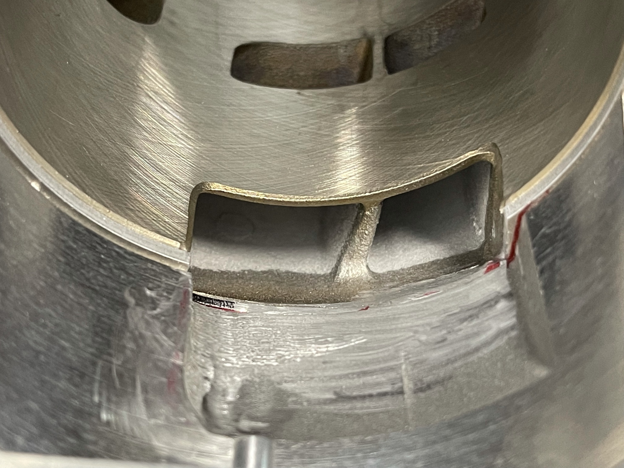

GT6MK3 Posted May 29, 2021 Author Posted May 29, 2021 More work on the left rear Getting close to happy with the rough in Might just smoote the inlet ram a little more at the rear corners

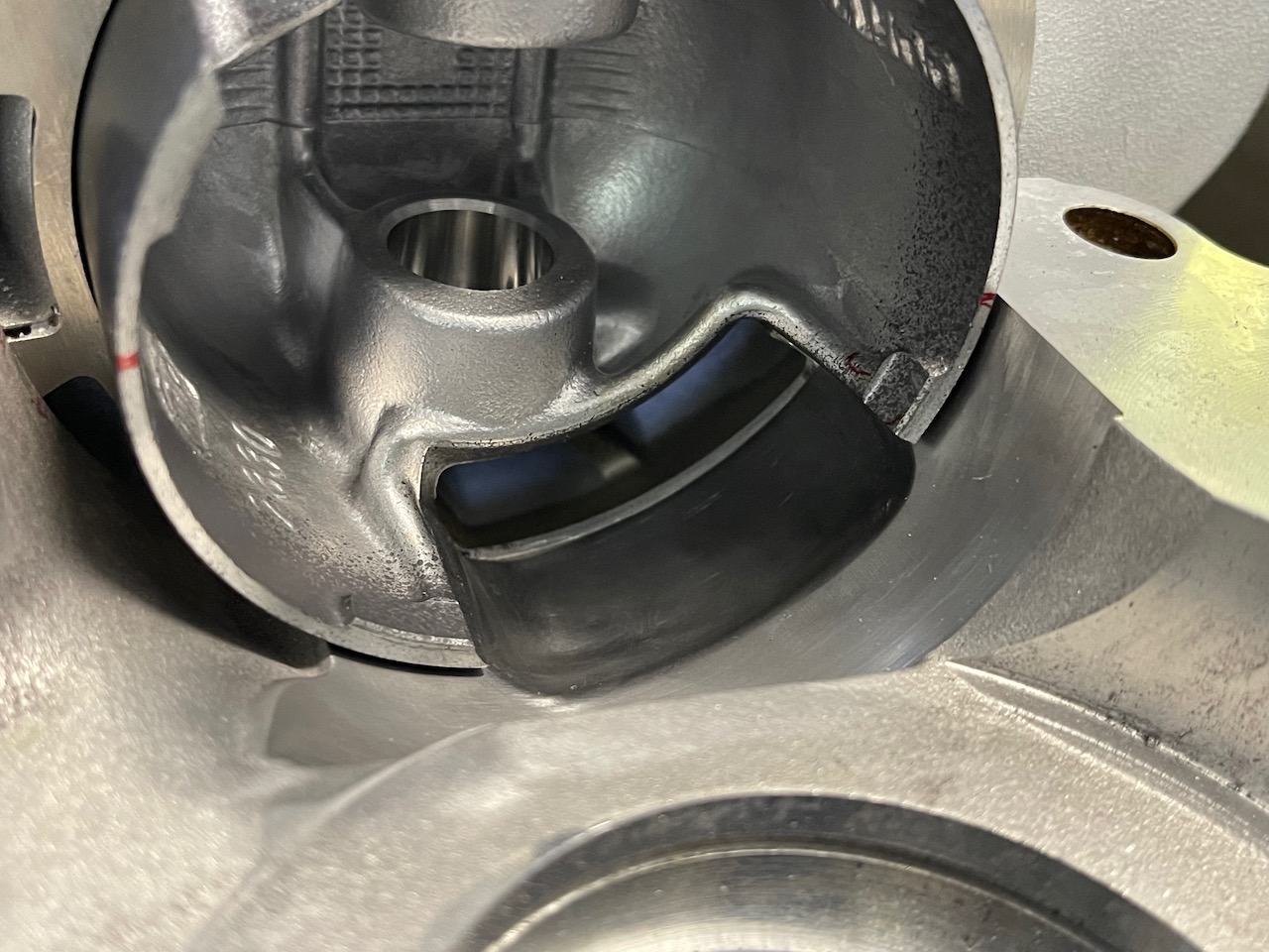

GT6MK3 Posted June 1, 2021 Author Posted June 1, 2021 Upside down 2 stroke pistons are a right of passage. Working on the clutch side port today. I couldn't figure out a way to line up the piston properly with the eccentric ports, to I bolted it all back in the flyside, then broke out the laser to let me mark the piston skirt where the casing join is. Next I marked up the part where the metal was in the was of the air. Rough cut Getting close Finished. (Note the red mark on the piston skirt for alignment) Time for the top ports.

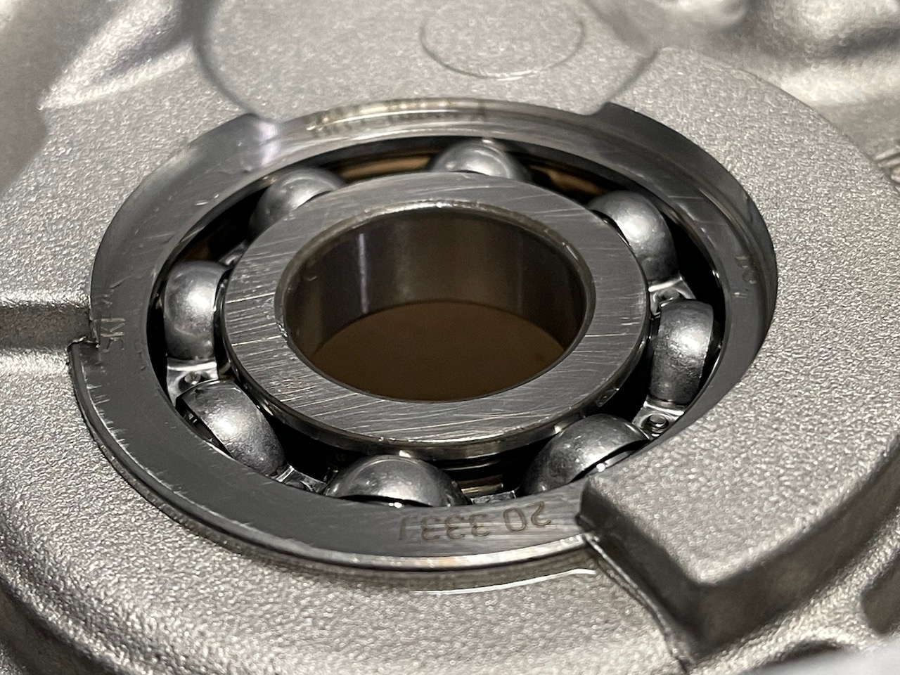

GT6MK3 Posted June 7, 2021 Author Posted June 7, 2021 Still a while before sealant time, but I'm glad you reminded me. The shiny new cases are lovely, but the milled flanges show no particular signs of having been deburred. With no gasket, I want to faces to be as flush as possible, so to mitigate the risk of of any burs causing interference I 45 degreed all the edges both inside and out with a file. The filed finish (outside edge) isn't as pretty as the raw (inside), but "function over form", and you can see how much tiny swarf came off. Next the bearings went in the freezer, and the case halves spent 30 minutes in the ez-bake at 135 Celcius. The clutch side (as always it seems!) needed some assisting with a bearing drive, but the cases are nicely reinforced, so it was soon in snugly and given a wd40 bath to drive off any residual moisture, then circliped in securely, with the clip in then turned 90 degrees to make sure its seating. The fly side dropped in nicely with a light tap. At that point I called it a day - gotta spread the work out over lockdown! 1
