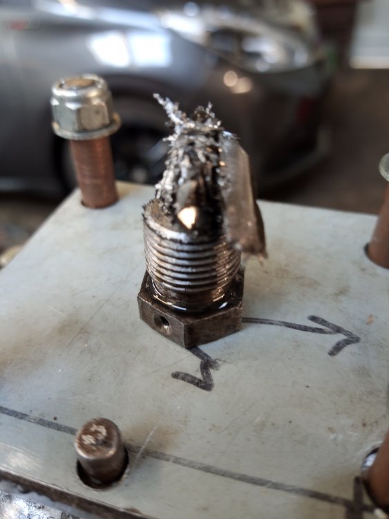

JohnD Posted May 8, 2021 Author Posted May 8, 2021 I gear so, Nick. I'll try again. Does this work. Gearbox and engine out, drawing 'box oil, and more shrapnel on the magnetic plug.
Nick Jones Posted May 8, 2021 Posted May 8, 2021 Pic works .... but there is (another) whole tooth on that magnet . Thought there must be one or two left in there.......
JohnD Posted May 9, 2021 Author Posted May 9, 2021 18 hours ago, Jdowson said: Nasty, on a positive, the magnetic plug works. Up to a point! I changed the gearbox oil in the paddock and got three teeth and a lot of swarf out, but as Nick says there's the rest to come. Gearbox rebuild booked (thank you, Mike Papworth!) but any trial must await the engine rebuild.
