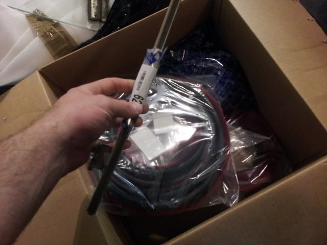

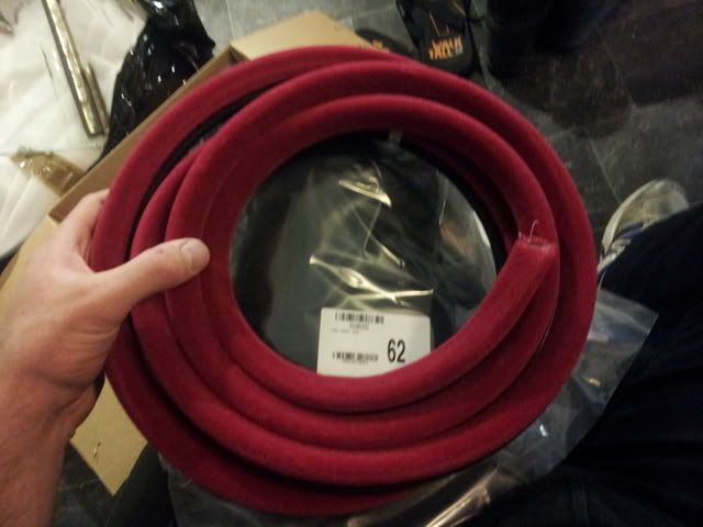

Today bits arrived from Rimmerbros.
x2 red door seals
x2 rear quarter light seals
x2 front door channel felts
x2 rear door channel felts
x1 rh rear door channel
I then had five mins spare so fitted the rear felt to the new rear channel.
Its a nice snug fit and should help keep the glass ridged and the wind out. After putting up with the spitfire windows tucking out at speed these gt6 door quarter lights and glass are much more ridged and give the car a really nice finish. As will the red coloured door seals.
They look lighter in person.

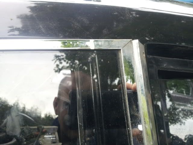

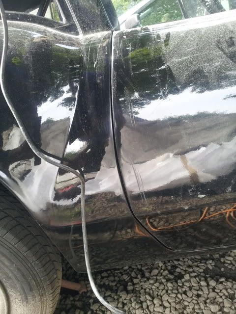

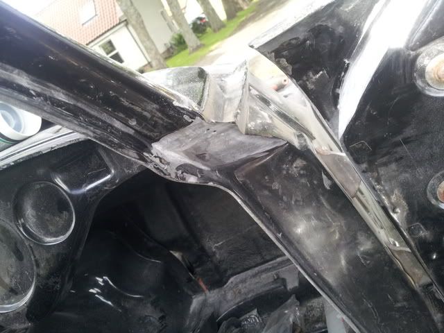

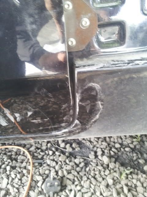

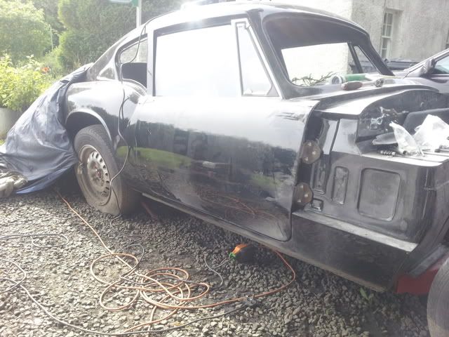

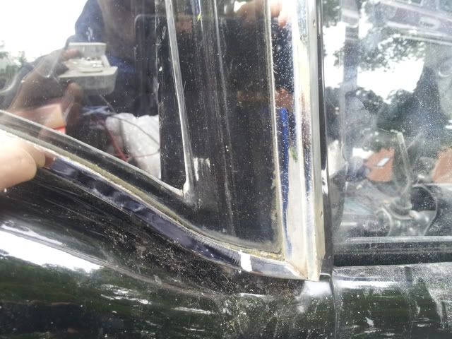

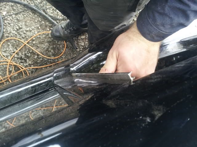

Well, out of the blue I got a day off. Was training right through last week and this weekend so I decided to do a bit to the car.

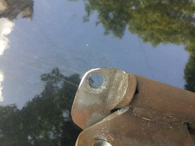

I've been having trouble getting the doors to fit how I want so today I opened the drivers door bolt holes up to give more adjustment and also ground down the edges of the door hinges to give more clearance.
Before
After
I also did the same to the threaded plates on both sides of the hinges.
However this didn't really help as the door needed to be raised first. So I began trimming the door and tub to get a nice fit.
After a fair bit of work the door fitted and then I had a look at it opening and the other gaps on the door.
Pictures speak a thousand words.

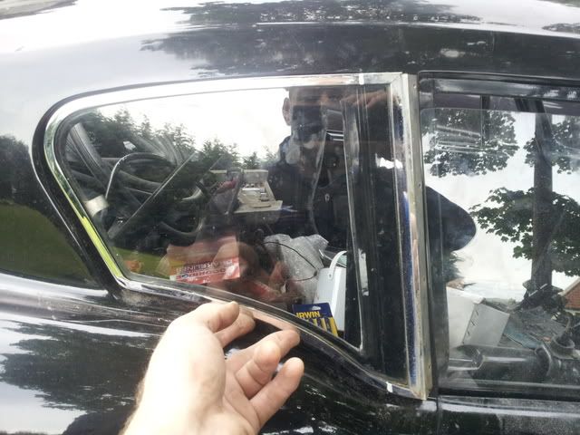

I then fitted the drives glass and runner and alighned the quarter light in the door and WOW does it look the Mutts Nutts.

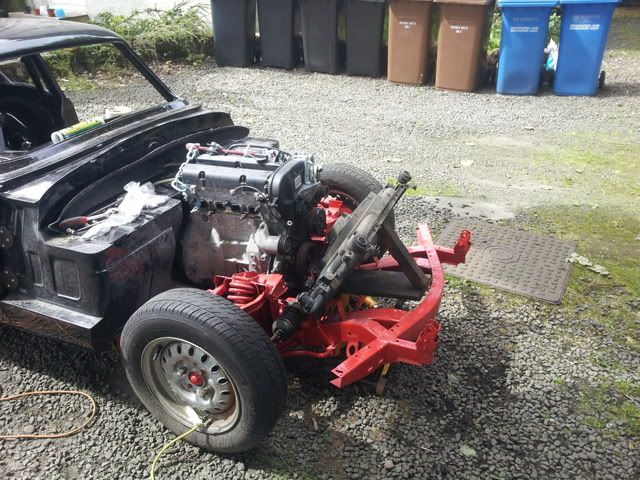

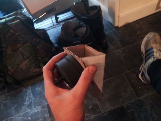

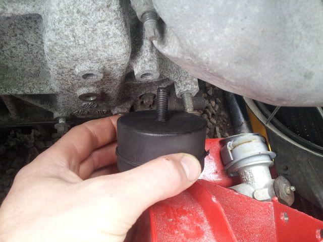

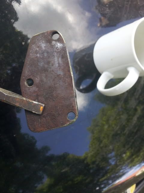

Ok so today I was lacking in energy so decided to do something easy. Engine mounts!!!
Here are the type of mount I've chosen and the place I wish to fit them.
LEFT
AND RIGHT
The idea was that they can either sit on the ribs with a hole through the turrent. The ribs should easy be strong enough to hold the mount but to make sure I'll fill the gap with spacers the width of the mount. Its the same on both sides and places the weight of the engine through the center of the turret. The mounts to the engine were then made from cardboard which will then be handed to the local welder to fabricate. They are very simple and should hold the weight well.
Left side
Right side
The mounts are angled to keep the engine central and steady.
Chris.
Posted
The Caterham/Jag E-Type engine mounts are good, just a mention, they are rock solid and really tie the engine to the chassis, desiged for 300kilo engine. They have a low profile and have two handy bolt holes and a metal mount plate they also have a captive nut and so alignment and removal is easy as there is no stud/thread attached to them. No engine movement at all; good for tight exhausts and firm feel.
That door shouldn't need that much work, clearly it now fits and looks correct, the mould or door mould at grahams must have moved? Make sure the door works right with the seal in cause the seal runs close to that area you doctored and doors and seals are generally a pain in the arse, the trim panel also adds thickness to the shell of the door. Same story; fitting the door, and having it close with all the seals and not need slamming or popping open onto the safety latch etc are two different things...
There is a more solid version of that mount available with two metal discs as part of it, one on either end and one in the middle the rubber is then in two parts so it makes the mount alot stiffer. You'll find the engine vibration minimal anyway it's a modern engine it's well balanced!

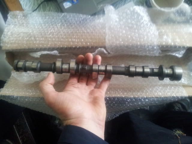

I might have just spotted a pair a cheap fast road cams for my Zetec se 1.6 (newman cams) so might have a punt. Don't need them but it wont hurt, they are rated at 145bhp.
Chris.
Posted (edited)
Well I won them. 1x pair of newman fast road cams.
http://www.ebay.co.u...9#ht_750wt_1270
A 1.6 Focus with standard inlet manifold, modified exhaust and a remap they help to make 135-145. So with the ITB's should be interesting. Didn't really need them but this hole car is really just for fun. :)

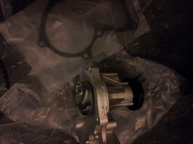

Also Ordered a cam belt and water pump kit with locking kit to make the job easier. I also ordered new spark plug leads and the hydraulic type 9 gearbox conversion kit. Tomorrow I'll order the protech shocks and go to see the metal fabricators to make the mounts as they were not in today.
Chris.
Posted (edited)

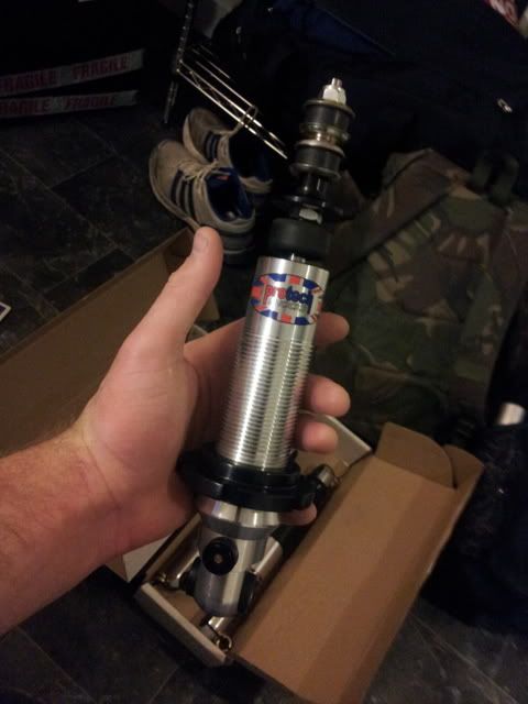

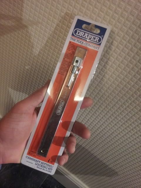

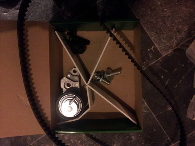

Well I arrived home from training abroad to a bunch of parcels so I decided to show you some of my automotive porn. :D

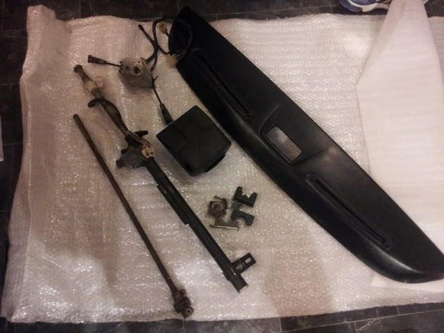

Spitfire Graveyard found me a late 1500 steering column and bits.
The Zetec SE water pump and cam belt turned up.
and obviously you need the locking pin kit to fit the above.

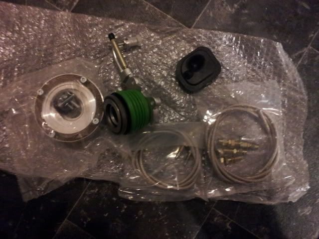

Next was the type 9 gearbox hydraulic converter from retro ford.
So where is the porn you say...........

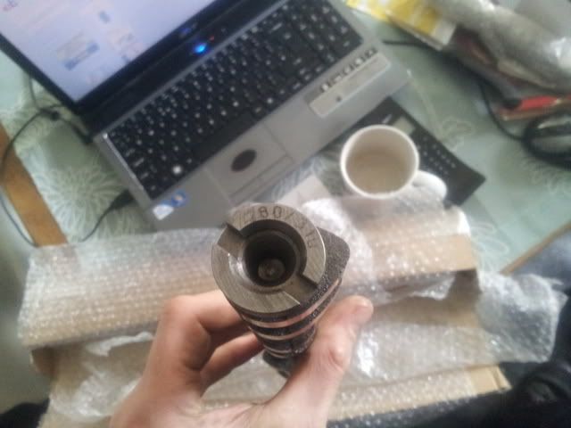

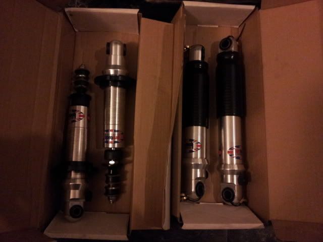

Protech Shocks...........Wow.
these are so good looking, and they are really light too. Quality is superb.
And the front
Yum yum.
Chris.

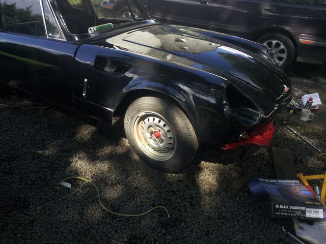

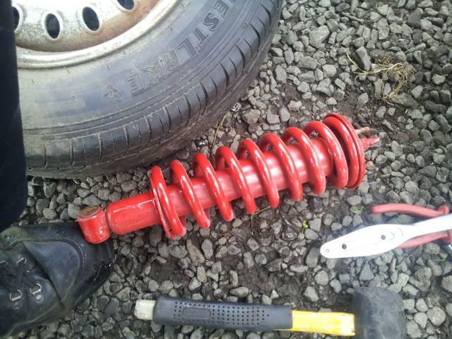

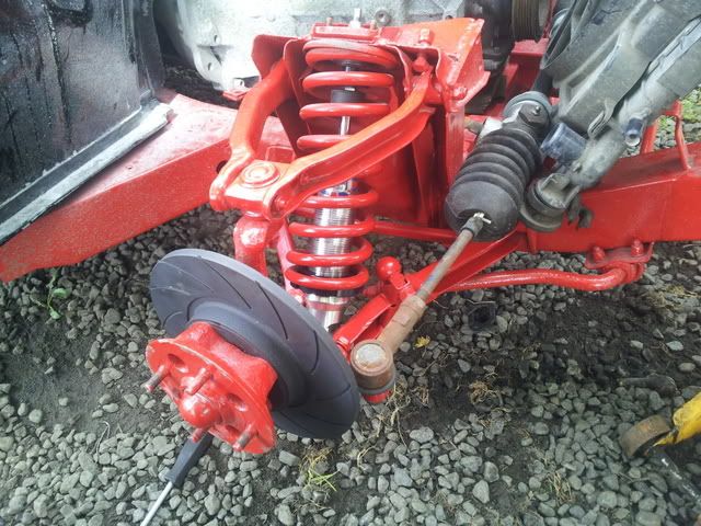

Well I used the only bit of energy I had today to send an hour or so fitting the discs and front shocks.
Out with the old shocks.
In with the new.
To give the same ride height I wound the adjuster down till it seated and then counted the notches on the bottom spring adjustable plate as I turned it up. I just gave it a rough setting of 15 notches and then I put 4 clicks on the damping. This will do till the test driving begins.
Yum Yum and now the car sits lower but its still missing alot of weight off the front ie coolant rad cowlings etc. But for now this will do.

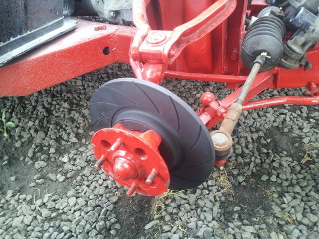

I've also made the decision today after looking at the standard hubs that I'll be buying the canley's uprated hubs/stubs and trunionless uprights next month. Might as well make it the best it can be.

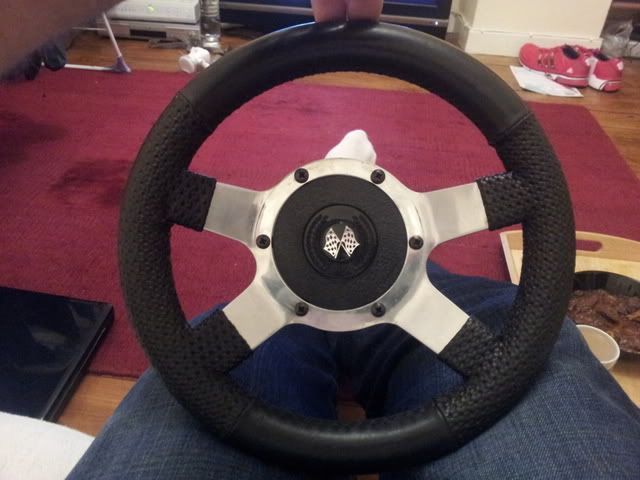

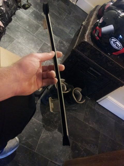

Well after a couple of months away from the car I got back from the Olympic's last night. Today I opened the parcels that had arrived.

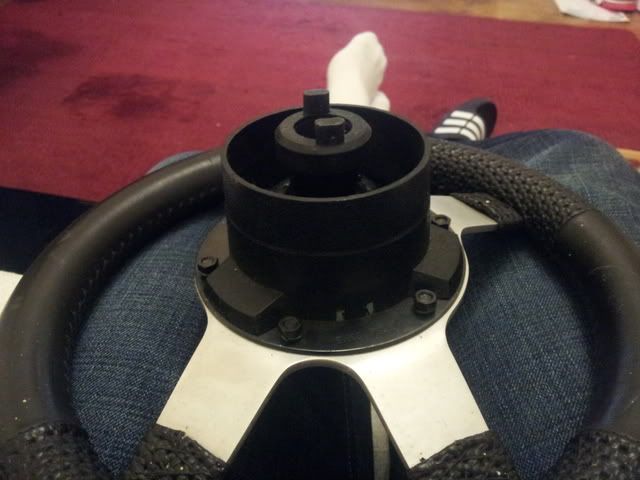

One steering wheel with Genuine Astraili hub to fit a spitfire 1977 onward. One low profile rear water take off for the Zetec Se engine and one pair of Progressive front springs from Gareth Thomas.
This is the same wheel as I had in the old spitfire but its in better condition. Another helpful thing is the boss or hub adaptor see below.
Most people have problems with the aftermarket hub being too big however as you can see above the Genuine Astraili Hub has a black plastic cowl that can be removed so the wheel can fit into the later switch cowling more easy. A very interesting thing for anyone with a late spitfire wanting to fit an aftermarket steering wheel. I'll update again once more has been done.
