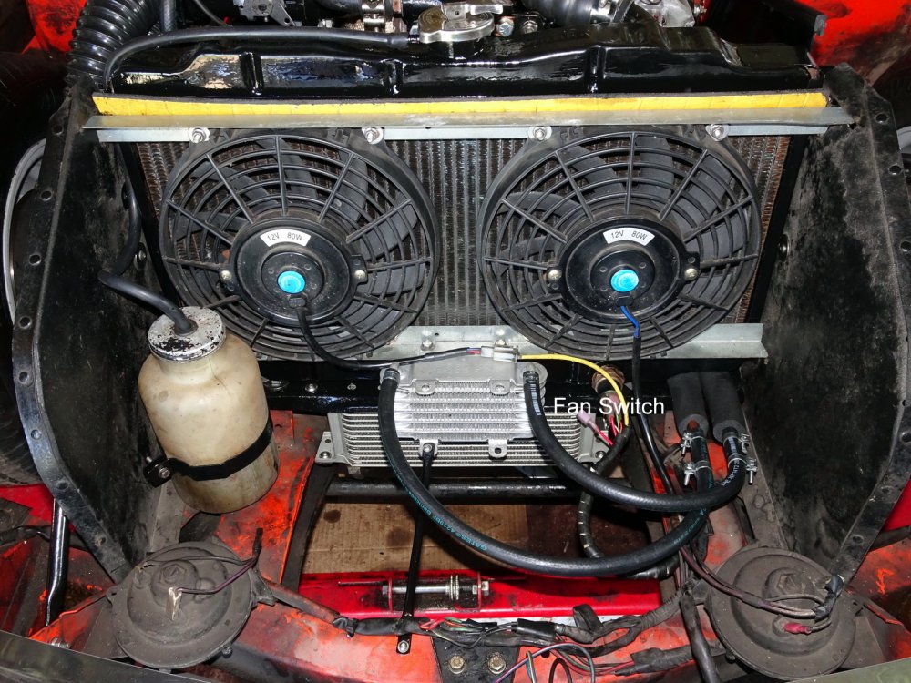

Hello Mark
                   I fitted a dual temperature one on our Spitfire but I have 2 fans (Intermotor 50101 83-79 & 88-83) in bottom of radiator
I fitted a small center off switch and 3mm leds in the H frame and leds come when fan does all through fused relays
Here is a list of them all

Here is a Link to the Intermotor website which will give more detail including the make and model of the car it fits.
Hope this helps someone.
Roger
