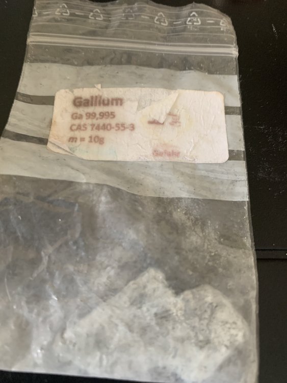

A more troublesome and quicker acting contaminate was Gallium - this would cut through the Ali with all the hairy stuff.
When we X-rayed for this we looked for black spots - holes in the ali.
