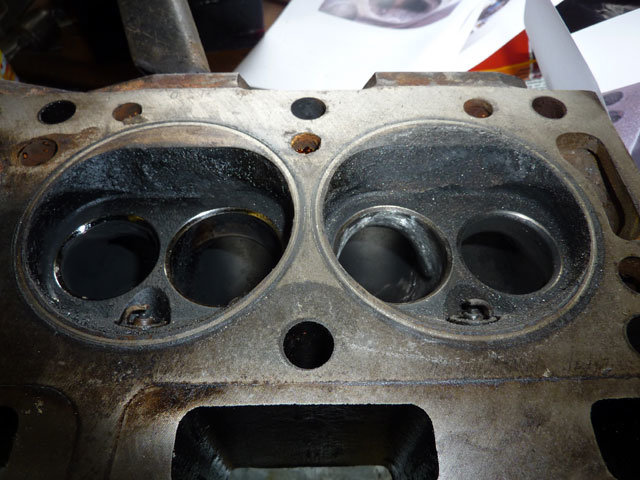

Nick Jones Posted April 9, 2012 Posted April 9, 2012 This is a follow-on to http://sideways-technologies.co.uk/forums/index.php/topic/690-diy-heads/ and should be read in conjunction with it. Didn't want to add this onto the bottom of Neils excellent thread, but make no mistake, I'm drawing heavily on Neils information. I've added some observations of my own too. The victim is the head from my Mk2 2.5PI. FWIW the number is 218225 though for the purposes of this modification they are are pretty much the same apart from the 219016 head from the 2.5S which are quite different in the inlet valve throat area. What will vary from head to head is the amount of core shift. What the hell this that? Well this head is quite bad, so I'll show you....... When the heads are cast, after the main impression is made in the sand which form the basic shape, cores are laid in that will create the voids for the waterways, ports and the basic shape of the combustion chamber. The port cores want to be positioned so that the centre of the section that forms the valve throat is concentric with the position the valve guide. That means that when the valve throat and seat are machined later you get a reasonable blend of shapes without any serious steps. The pic below shows that the cores on this head were too far to the left so there's a pronounced step in the short side radius and an undercut below the seat area on the far side. This one shows the undercut better. This is the bigger problem really as the SSR step can be cleaned up, but this really needs material added. About all you can do with this is to chamfer the sharp edge. You are limited by the need to leave plenty of material under the valve seat. DO NOT undercut the seat! This is my attempt I don't know how big an effect on flow this actually has. Another interesting thing noticed was the evidence for high and low flow areas in the valve throat. Yellow arrows show the cleaner areas indicating higher flow, Red arrows show heavier deposits indicating low flow. The section just next to the exhaust valve appears to have the lowest flow by some margin. Green arrow shows what appears to be the "flow shadow" of the valve stem. Never seen this before and I think it's partly due to this being an injection engine. It's not equal on all cylinders, which may be telling me something about the state of my injectors. Blue arrows show areas of heavy deposits that always seem to form in these corners indicating stagnant areas. As a general comment, this head came from an engine which was a VERY heavy oil user. The flow patterns don't show through into the combustion chamber all that well. This may be because I wasn't using the engine hard before it was dismantled.

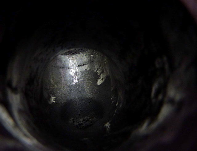

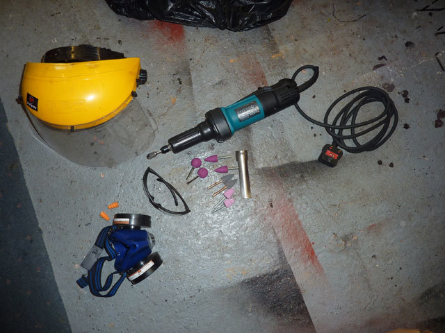

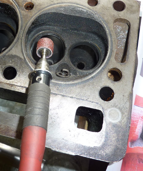

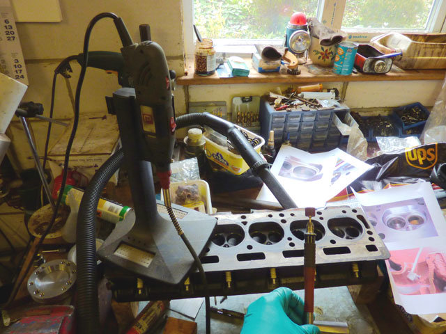

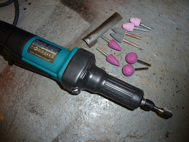

Nick Jones Posted April 9, 2012 Author Posted April 9, 2012 So, to the port work. I've done these before. Last one I did was the Vitesse one, with a biggish Dremel-type thing (I used it here for the finishing work and it's shown below). This was £ 30 from B & Q several years ago complete with the flexible extension and a good selection of accessories. It's a good tool and very versatile. I've bought a few small carbide burrs over the years but it still takes AGES to remove much material. So this time I treated myself to a proper electric die grinder which is something I've wanted for a long time and will use for many things. Cost £ 85 delivered, which I thought was pretty good value. I also bought some stones of various shapes from these people. http://www.abtec4abrasives.com/mounted-points-wheels-and-burrs-for-portable-machines-57-c.asp Not used them before but I will use them again Of the stones pictured, I only actually used the round one - this one http://www.abtec4abrasives.com/a-25-mounted-point-ra-60-rv-685-p.asp. It's a little bit big - not a problem for me as I wanted the guides out anyway but if you want to leave the guides in, choose the next size down. I also used the carbide burr that's shown in the grinder. I've had that in a drawer for years. Note that it is a "bullnose" one and not really the right shape for this job as it cuts on the end as well, making it all to easy to dig ridges as you are cutting right around the curve. The one Neil shows is a much better shape for the job. Also in the first pic you'll see the visor, earplugs and dust filter. What is not shown is the vacuum cleaner which happens to have an attachment which wedges nicely into the ports and was left running while I was grinding. After the small tool, the die grinder and carbide was quite a revelation - take it careful or you'll be through to the water before you know it! I was also paranoid about taking a divot out of the valve seats so made a policy of not starting the grinder until the tool was in the port and not taking it out until it had stopped turning. First cut as per Neils guidance and measured with homemade depth gauge similar to his. You also get a sense of the size and shape of the core shift step in this pic..... With the carbide I was using I had to be careful not to dig too deep at the back and make a step. Having set the datum I then put a permanent marker line down the deepest point of the cut to try and stop myself digging any more out of there and used the carbide to open out either side, with the deeper, more laid back angle biased towards the outside of the chamber. The carbide is a bit fierce so I soon swapped to the round stone as it's wider contact patch and shape make it easier to form the gradual, smooth curves that a needed. Just kept it moving back and forth around the shape of the curve, using only light pressure and pretty quickly got to this Note the deeper cut with the shallower angle biased towards the chamber wall. Hardest part was getting a smooth blend up round the bend - partly due to the carbide having left ridges initially I think. Then polished up using the sanding drum on the small flexitool and got to this Quite a marked contrast to the unmolested one next to it!

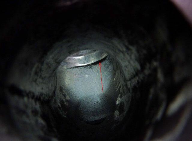

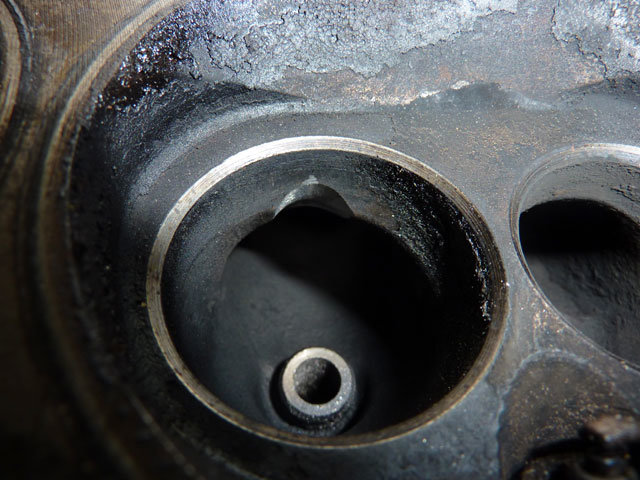

Nick Jones Posted April 9, 2012 Author Posted April 9, 2012 On the exhaust side I restricted myself to chopping the bulge in the guide boss away and smoothing the short radius which was also very sharp due to the core shift. I haven't moved much material as the head will have inserts fitted for unleaded/lpg and I was warned these will be quite deep. Likewise, on the chamber itself I've just radiused the corners where the sloping sections of the squish ramps meet the vertical chamber walls. I'm not expecting this to have much effect on flows but I'm hoping it might aid a more complete burn. Not much material removed - less than 5mins per chamber with the small grinder and fine carbide burr. I did this much more aggressively on the Vitesse head and had trouble getting the CR back up. Not such a problem on this head as much less material removed and 2.5 so more spare material. In any case I don't mind a smaller chamber on a 2.5 as this adds squish area and I think this helps the engine run at higher AFRs. I've not yet had the head off the Vitesse to see if this treatment has reduced the deposit formation in the corners. Next job was to fit the new guides. I just bashed the old ones out with a brass drift and lump hammer but fitting needs more subtlety. I've got a small press so I made up a little tool out of an old valve stem and piece of 8mm strip plus cut a section of box to 16mm as a stop to set the insertion depth. This worked fine on the inlets. However, when I got to the exhausts I discovered the 5 out of 6 are undersize and can be fitted by thumb pressure or even gravity....... More crappy parts - see post in rant section for vid of valve guide going in under gravity! Cheers Nick

Sam Posted April 24, 2012 Posted April 24, 2012 To finish off the inner radius, I cut a long thin strip of sandpaper off of a beltsander, and used that to do the final shaping - you can really tug on it to flatten out the lumps.... it can be hard to get it smooth with tools poking in from each side. Your finished product looks very similar to mine - I think I removed a bit more material on the shoulders, and mine is a rougher finish on the inlets...but its a1500 head so a bit different anyways.. Is polishing the exhaust ports a good idea? It's not like the inlets where fuel has to atomise or anything.
Wolfrace. Posted April 24, 2012 Posted April 24, 2012 Is polishing the exhaust ports a good idea? It's not like the inlets where fuel has to atomise or anything. Just clean it up and match it to the manifold, within miutes of starting the engine it will be sooted up no matter how mirrorlike the finish.

Wolfrace. Posted April 29, 2012 Posted April 29, 2012 Alas, metallic dust and electrikery are poor bedfellows, and cast iron dust is particularly bad with electrics.
Nick Jones Posted April 30, 2012 Author Posted April 30, 2012 You are not wrong...... especially when the vents in the casing direct the flow in such a way that it deposits a stripe of metallic dust right across the narrowest point between two exposed tracks on the pcb..... arc - kaboom..... eeek! bollocks! Cleaned it off, mended the vaporised track, replaced fuse......... still dead. Something else is kippered as well. Not much else on pcb so might still manage to fix it..... I have another but it died the same way some time back and has already donated some mechanical parts to this one. Wasn't even very near the work area this time as I was using the flexidrive and had the hoover going too....... B & Q seem to have stopped selling them. Nick
Wolfrace. Posted April 30, 2012 Posted April 30, 2012 It's the magnetic field inside the rotor, attracts micro fine iron dust and kaboom. When I was on the tools, one of the factories on my patch used to machine graphite components. No matter how well you sealed things, that dust always managed to find a way in to play with Mr Sparky. I use air tools for grinding iron. Apart from being short proof, they also stall rather than snatch and kick back if you get too enthusiastic with them.
JohnD Posted May 1, 2012 Posted May 1, 2012 (edited) Perhaps you could insert the tool into a plastic sleeve? But then it would need to be ventilated, which needs a compressor.................... I have one, initially to do heads with an air die grinder. Over the years, I've acquired several air tools, from a simple tyre inflation gauge, to a Desoutter air file (narrow belt sander) that can produce a gorgeous finish on welds. An air hacksaw is one that I've found very useful, while the air screwdriver I've never used in anger! But I'd not want to be without them. A compressor is a costly, but very useful ......... not 'tool', more 'resource' for the serious garagiste. John (PS. If you're thinking of getting one, mine has a direct drive from motor to compressor, rathar than a belt. Makes it compact, but also VERY NOISY!) Edited May 1, 2012 by JohnD
Wolfrace. Posted May 1, 2012 Posted May 1, 2012 You can drown out the worst of a direct drive compressors racket by putting it in a rockwell bat lined 'dog kennel'. The ends need to be open for ventilation but mount the ends also covered on the inside with Rockwell bats stood off - just make the top longer than the sides, so you keep a reasonable air gap. Sound wil not go 'rounded the corner' and Rockwool bats, (you can get proper acoustic grade if your feeling flash, but the ordinary ones from B&Q work pretty well), are good sound absorbers'. We used to use these in the workshops and they are surprisingly effective at taking the sting out of the racket.

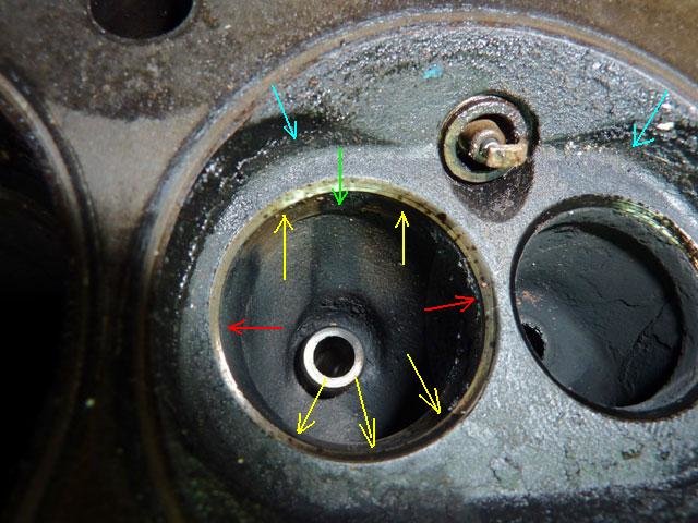

Nick Jones Posted July 1, 2012 Author Posted July 1, 2012 Got the head back on Friday with guides reamed and unleaded inserts fitted. Just ground in the valves. The inlets sit a bit low in the seats (slightly bigger valves would be better) and you can see that there is quite a bit of unused seat area on the port side of the valve (the shiny bit). So I popped it in the "lathe" (electric drill in a vice will suffice) ........ ......... and back-cut the outer edge of the back of the valve until just short of the matt grey ring that indicates the ground in area. Should give a little more flow, especially at low lift and is very quick to do. cc'd the head and got 43.3 +/- 0.1cc. That gives approx 9:1 and I want 9.75:1 so I'm going to need to take about 0.85mm off. ONce that's done the head can be popped on and I'll have no excuse not to fit the engine..... deep joy..... Nick

Nick Jones Posted July 4, 2012 Author Posted July 4, 2012 Ah, typing too slow, interesting comment about the back-cut being more effective at higher lift Gareth. I wouldn't have expected that...... What also surprised me was just how little flow seems to go through the side of the valves at right angles to the port (as evidenced by the soot shown in the pics in my first post). I'd have expected more on the side by the exhaust valve than the side by the chamber wall...... Going off at a slight tangent, I've always wondered how comparable the actual flows are in a running engine (not steady state obviously) are with those obtained on a flow bench at steady state? I suppose it's irrelevant really provided best steady state flow also gives the best result on a running engine. Nick
