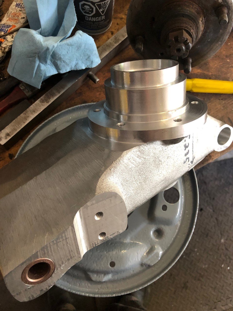

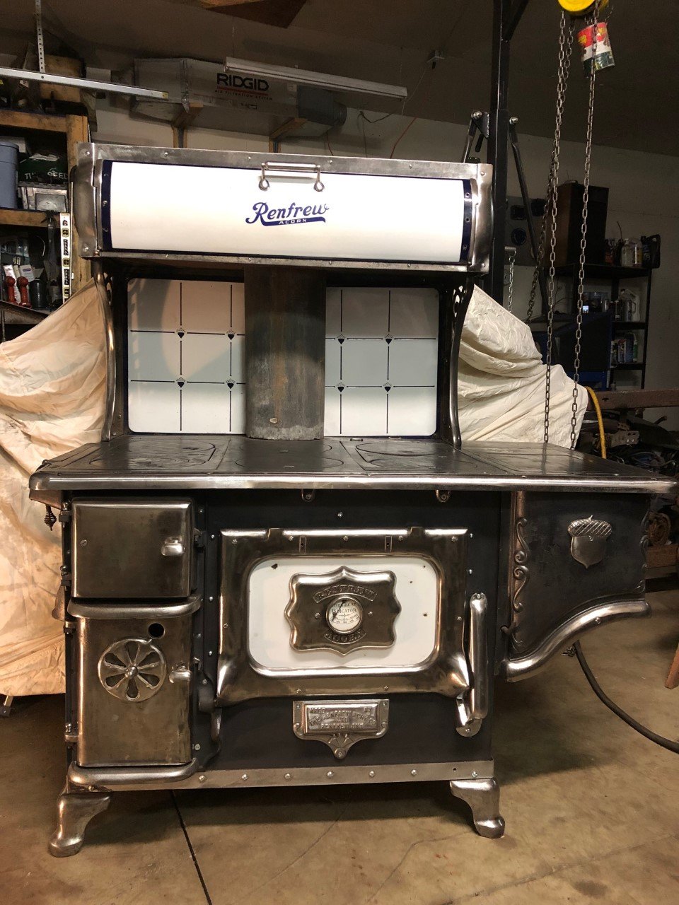

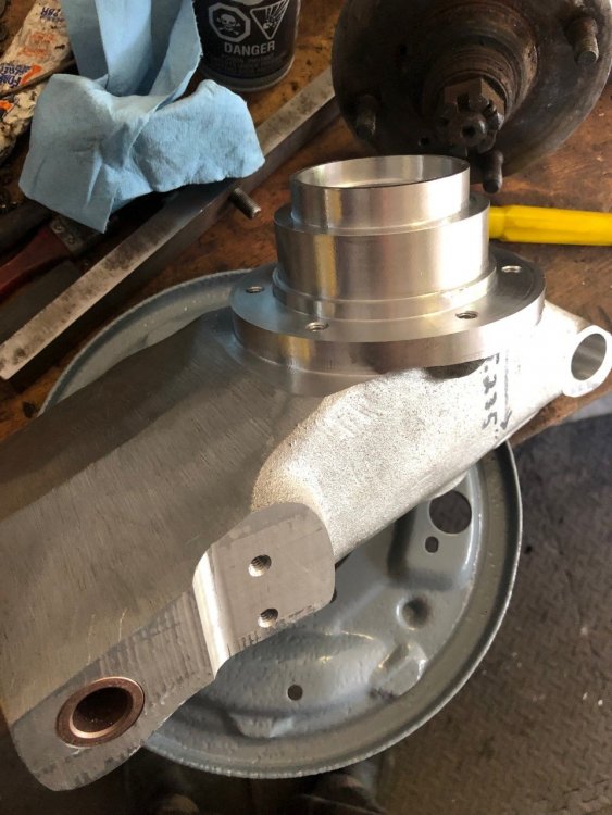

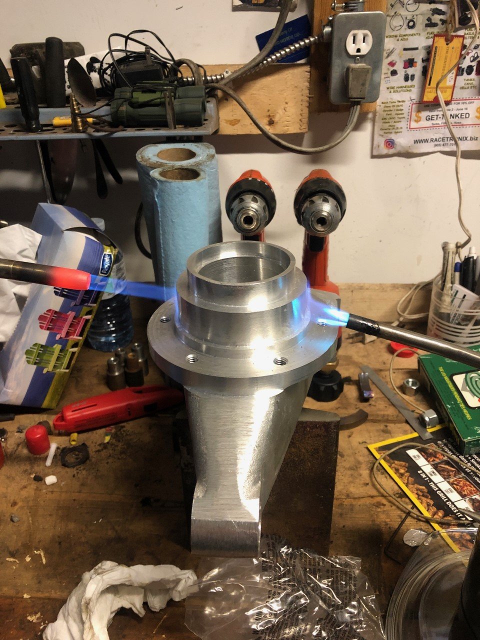

Been a while since I've occasioned the Sideways forums. Lots of projects work and play have been keeping me busy during retirement. I'll post a few picks of some of the parts i've manufactured for the TVR and Lotus Vintage racing and restoration crowd. I was wrangled into this by a local expat who races an original Lotus 7 and TVR Vixens, Interesting but challenging work as some parts are NLA and no dimensions to work from. One of the TVRs he is restoring, for someone else, has a Ford Cosworth 2.2? litre, turboed and producing 370 HP at the crank, killer stuff. There is also a Jensen Healy in the stable he brought with him from the UK 20 years ago, he put 8,000 pounds into the eng ine alone , pumping out 220 HP, essentially an esprit engine. I'm still carrying on with the GT6s but restoring an early Ford Bronco is taking up a lot of the shop. Pics in order: TVR Vixen custom cast upright, heating up to press in new bearings Finished machined casting An antique stove I tore down and rebuilt for a friend.

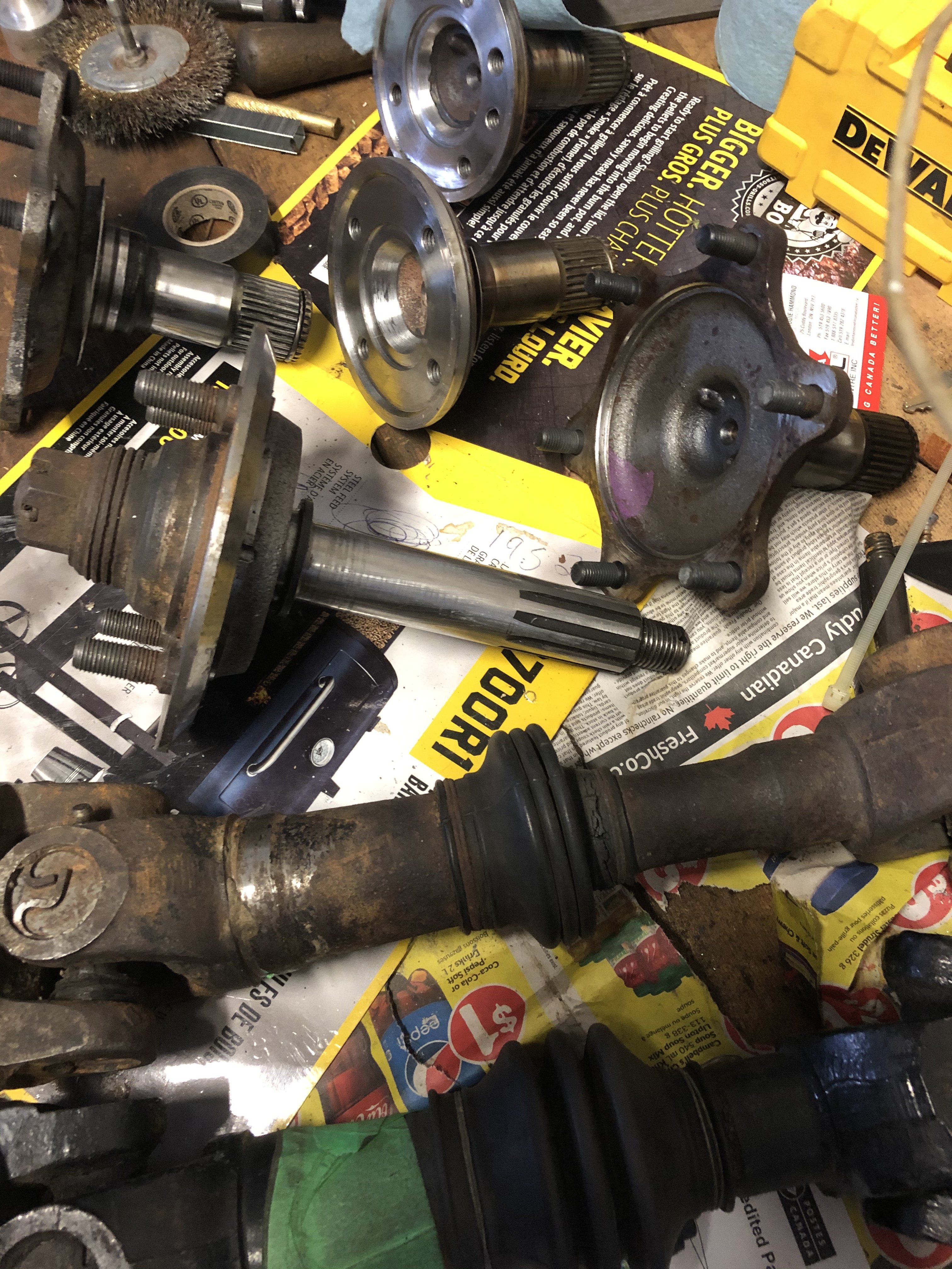

I have been considering a replacement for my very sketchy Rotoflex discs. Having just shortened a drive shaft to accommodate an overdrive I was struck by the fact the flanges are shared between the axles and propshaft. Taking this further, rather than going the Steve Smith route with Datsun 240Z axles shortened and flanges adapted, why not shorten a driveshaft to about 15", cut off the rotoflex fingers from the stub axle and weld a flange on it. There is plenty of travel on the spline, more than is required, the incline angles aren't that bad to begin with even at full suspension travel. Any drawbacks I'm not seeing? I've added a pic of the Datsun axle for posterity, it still needs to be shortened. Cheers Tim
