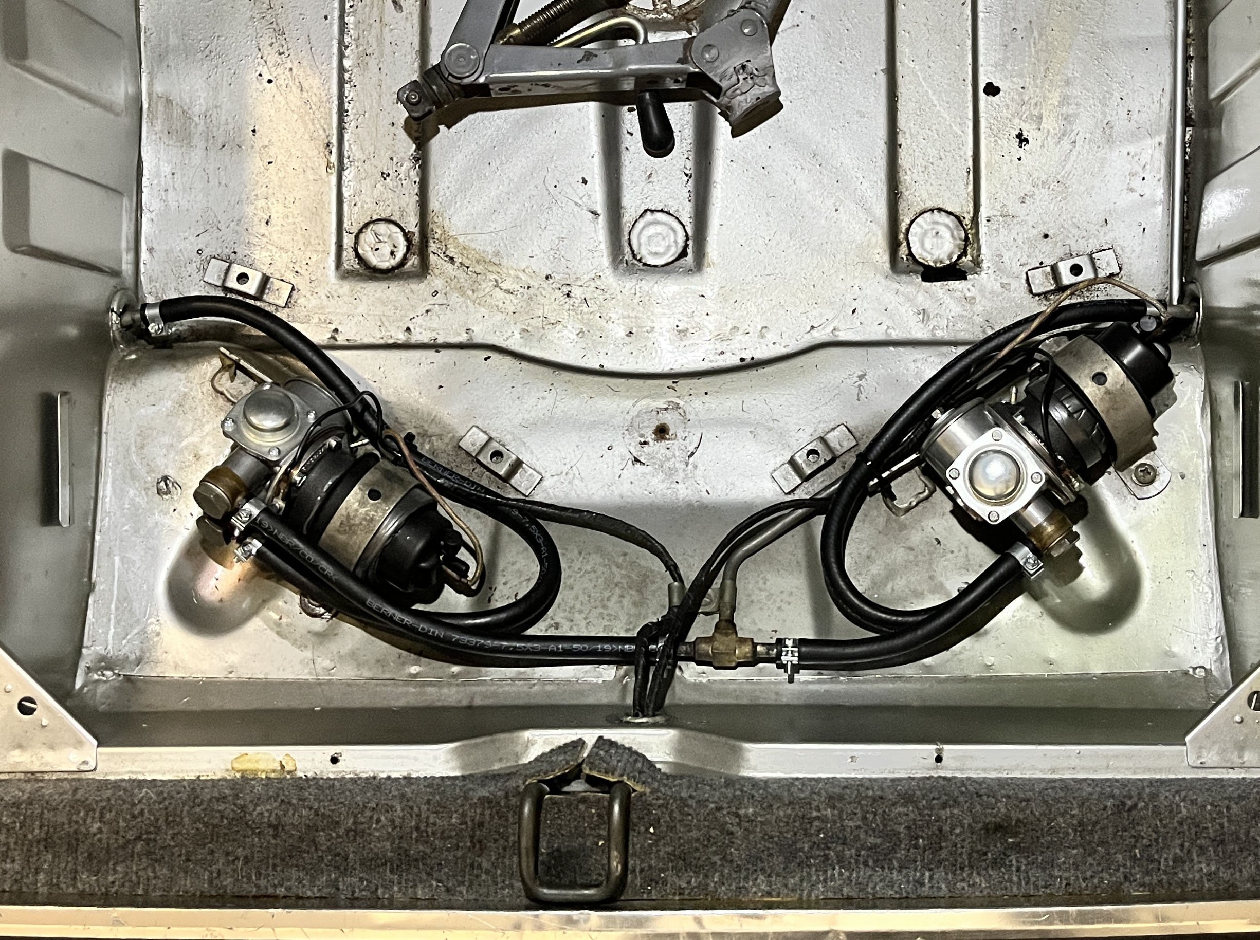

PaulAA Posted March 12 Author Posted March 12 2 hours ago, thebrookster said: I was wondering if the "choice words" of the wife was down to the fuel consumption, or maybe how that figure was achieved? Harsh. Honest, guv - I drive like an aged don in the Jag... if there's anybody looking. This shocker emerged on Sunday evening. I'd managed to get both tanks to almost empty over the winter, and I'd brimmed just the left tank the previous evening and seen the needle sit plumly over the '4/4' mark. But on Sunday morning it was below the '3/4' mark ('ah, ze first clue, Monsieur'). Squeezy float? Tired sender unit? 185km later, having intentionally run it off the left tank only, with the express intention of vainly seeking reassurance that it doesn't consume that much, the tank was empty. 44 litres empty. Hence the desultory post above - 10mpg. Just to fill in the detail: tyres properly inflated, handbrake not applied, parachute not deployed, HD6s balanced and mixture adjusted with the Gunsen last summer, plugs looking only slightly blacker than they should. Most importantly, no leaking pipes either from gravity or under pressure. Seemed unlikely that that amount of fuel was being burnt wastefully... But yesterday evening, I wandered down to the garage and idly flicked over the tank switch to the right tank and the gauge showed it to be nearly half full. Having been practically empty on Saturday evening. Which, roughly balancing the amount of fuel I'd bought and the amount I still had, would suggest a more respectable 18mpg, give or take. The pipework on the Series 1 is pretty simple and doesn't include either a pressure relief return or a balancer between the two tanks, so the only possible explanation for this is that the (nearly new solid state SU) fuel pump on the right tank is allowing back feed. Having consulted the XJ community, this explanation turned out to be too simple - fuel cannot migrate between the tanks. Yeah, right.
PaulAA Posted March 12 Author Posted March 12 Two tanks, two pumps and a T-connector. Simple. Paul * Feel free to compliment the cleanliness of the underfloor area. 1
Escadrille Ecosse Posted March 12 Posted March 12 6 minutes ago, PaulAA said: Feel free to compliment the cleanliness of the underfloor area. What a lovely clean underfloor area 1 3
JohnD Posted March 12 Posted March 12 (edited) Paul, A few years ago(!) I asked for advice on how to plumb twin tanks (https://sideways-technologies.co.uk/forums/index.php?/topic/8972-theoretical-question-how-to-plumb-twin-fuel-tanks/#comment-122528) ) and received useful advice! In particular that some Jags had them. Recently, I bought a solenoid valve that such a Jag would have llke this. It's a simple, on-off valve. I don't see one in your pic. Just two fuel pumps and a T-piece. Does yours have the solenoid valve? I'd like to know where to fit it! John Edited March 13 by JohnD
Nick Jones Posted March 13 Posted March 13 2 hours ago, PaulAA said: Having consulted the XJ community, this explanation turned out to be too simple - fuel cannot migrate between the tanks. Yeah, right. And yet….. migrating it clearly is. Another collision of theory with reality Possibly mpg is indeed better than 10!
2.5piman Posted March 13 Posted March 13 Paul,. S.U. pumps have inbuilt check valves, that is the very likely reason for fuel ging to the right tank. It doesn't take much debris for the inoperative pump to allow fuel to pass. That is where I would look. Alec
JohnD Posted March 13 Posted March 13 Some rally cars have dual pumps fitted, for reliability through redundancy. But good practice is to fit non-return valves as well, else the running one can push fuel backwards through the non-running pump. John
PaulAA Posted March 13 Author Posted March 13 3 hours ago, 2.5piman said: Paul,. S.U. pumps have inbuilt check valves, that is the very likely reason for fuel ging to the right tank. It doesn't take much debris for the inoperative pump to allow fuel to pass. That is where I would look. Alec Thanks, Alec. That's what I've been looking for!
PaulAA Posted March 13 Author Posted March 13 11 hours ago, JohnD said: Paul, A few years ago(!) I asked fircadvicevon how to plumb twin tanks (https://sideways-technologies.co.uk/forums/index.php?/topic/8972-theoretical-question-how-to-plumb-twin-fuel-tanks/#comment-122528) ) ans received useful advice! In particular that some Jags had them. Recently, I bought a solenoid valve that such a Jag would have llke this. It's a simple, on-off valve. I don't see one in your pic. Just two fuel pumps and a T-piece. Does yours have the solenoid valve? I'd like to know how to fit it! John John The Series 1 cars (like mine) had a very simple set-up, relying on the inoperative pump to stop fuel being channelled to the unused tank, without additional valves. The pump itself determines the quantity/pressure of fuel being pushed through. The union of the two supplies is an open T-connector. Later cars had a single pump ahead of a change-over solenoid as per your image, which linked and regulated the feeds from the two tanks. Other than providing a return feed for excess fuel, the only effect of the change would appear to be to (i) save money on one fuel pump, and (ii) incorporate more opportunity for failure. Paul
