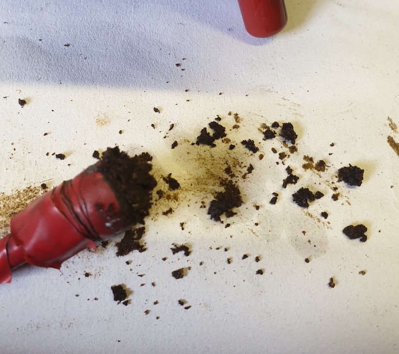

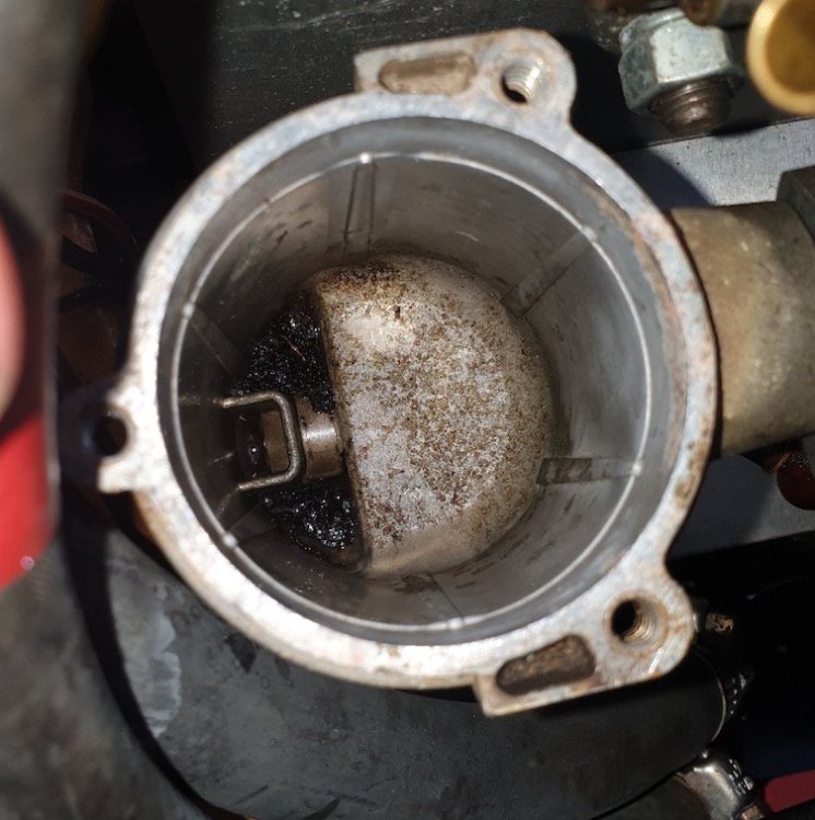

Mark Posted August 13, 2023 Author Posted August 13, 2023 Hi all Finally got around to having a proper look at the carbs. The fuel in the float chamber had looked clear, and a couple of days ago I emptied each float bowl, soaking the fuel up with a clean rag. It started getting dark so I left the car in the lock-up, and went home. Yesterday I went back to investigate, and I'm ashamed to say, after a closer look both float chambers, they are full of crud, trapped in the little sumps either side of the outlet. This is what I get for not fitting a fuel filter! Sure the float flooding was down to this. At first I couldn't really see anything, It was only when I poked around at the bottom of the float chambers with a scribe I disturbed the sediment, time for new reading glasses. I am surprised its ran so well for this long with the amount of crap that was in there. Looks like very fine rust particles from the fuel tank. Expected the pump filter to be full but surprisingly little debris inside compared to the carbs. The mesh filter inside the pump is very fine, and the rust particles in the float chamber are as fine as talc. I think the car has done less that 800 miles since its been back on the road. Anyway, stripped both carbs, and fuel pump, Fuel lines, thoroughly cleaned, blown through and used new jets and gaskets from the rebuild kit I bought several years ago. I bought an inline plastic filter that I am going to fit under the bonnet. Not a lot of space between where the fuel feed enters into the engine compartment, through passenger side front outrigger, and the fuel pump. I always thought it was preferable to have an inline fuel filter horizontal, but it would fit easier in the space vertically, so probably fit it that way, any thoughts? The Jets in the SU HS6 kit I bought appear to have a smaller diametre hole. These carbs are from a Sprint but I thought all the jets on HS6 carbs where the same size. The needle goes all the way into the jet flush with the bottom of the piston when tested, so the original jet may be enlarged through wear?
