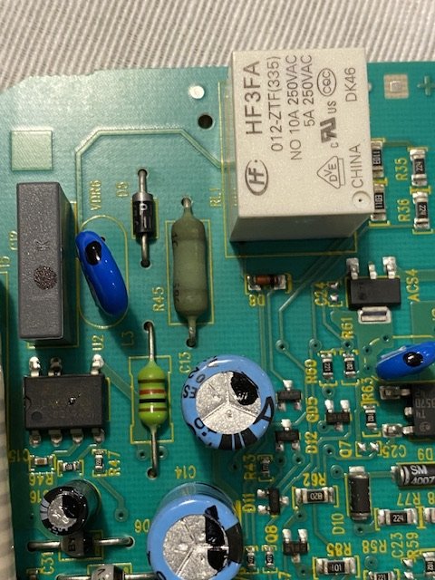

Nick Jones Posted December 1, 2024 Author Posted December 1, 2024 Something bad happened…… We don’t use the dishwasher very much these days as mostly just the two of us. However, we had guests last night so the dishwasher got loaded for the first time in several weeks, and this morning, after breakfast dishes had been added, I pressed go……. And nothing at all happened. Not even any lights when the power button was pushed. It worked fine last use. It’s an AEG “built in” model with plug behind it (not my doing!) so a fair bit of hassle to even check fuses/power. No faults found so we ended up in this position ….at which point I was able to prove there is power to the motherboard. It’s the dangling white thing. New motherboard is £200…. Bugger. Beyond what I’m prepared to spend on a 12 year old machine. So now we are here…. Nothing obviously fried/exploded, which is a problem for my level of electronics diagnosis - I like/need obvious clues! After a bit of belling through, my current working general diagnosis is that the low voltage psu for the controls is broken…… Need to narrow that down…. Which is probably going to involve powering it up. I’m suspicious of this area. Capacitor top left seems ok, VDR….. well, it’s not exploded! Diode is alive but the thing immediately right of that (R45 marked on board) does not appear to conduct electricity and does, perhaps, look a little cooked in the middle….. I can just read “10” on the left side of it and (I think) 5% on the right side. IC is and LNK306GN (probably “0&6” are partially obscured) which I’m assuming is doing the voltage regulator duty. This is the controller combined unit. Don’t seem to be any useful numbers on the boards themselves
DeTRacted Posted December 1, 2024 Posted December 1, 2024 (edited) Searching on the web gives R45 as a 100 Ohm 3Watt wirewound resistor. Others apparently have had to replace it. Of course if that is open circuit it might have taken other bits with it...........or vice versa of course. Edited December 1, 2024 by DeTRacted 1
Nick Jones Posted December 1, 2024 Author Posted December 1, 2024 Thank you Rob, your google-fu is very strong! I’ve been failing to find that information for some time. It’s definitely open circuit and nothing else looks hurt (I know, I know!), so it’s got to be worth a try.
DeTRacted Posted December 1, 2024 Posted December 1, 2024 The post I found is someone trying to fix one, and is in French - whether or not they succeeded is not clear but as you say it's worth a try Nick. Good luck !
Nick Jones Posted December 1, 2024 Author Posted December 1, 2024 Thanks, eBay has come through with a replacement, now ordered. I’ll report back. Owe you (another) beer!
Nick Jones Posted December 6, 2024 Author Posted December 6, 2024 Sadly I have to report a fail. New resistor arrived and was duly fitted. Everything plugged back in…. Powered up…. Which immediately produced smoke Same resistor New unused spare vs. one that’s seen 10s service. It had also gone from 99.6 ohms to 680k in that time. No other obvious damage but the LNK ic was quite warm and the ic/transistor “ACS4 above the resistor was hot and in fact seems to have the marks roasted off it on close inspection. It drives something off-board, possibly the pump and I belatedly note that actually the machine didn’t quite finish its last cycle as it has more water in it than it should have, though as it’s clean (rinse cycle) and at strainer level it’s not obvious. So maybe all triggered by the pump? It’s academic now. CBA to put anymore effort/time into it. Replacement on order. Just wondering if I can be bothered to try and flog any body parts.
