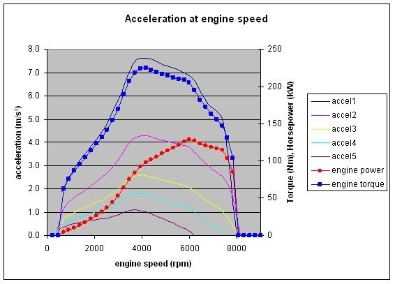

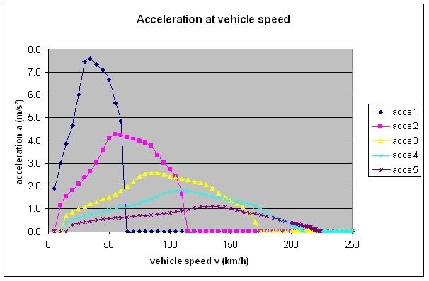

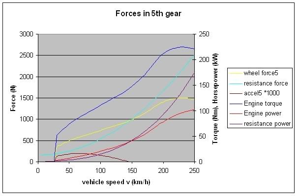

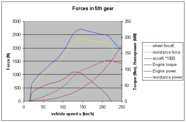

spitNL Posted May 28, 2009 Posted May 28, 2009 Here is the question given the same amount of torque, why does moving the torque peak and usable range to a higher RPM result in more thrust to the car? Considering the fact that there is more friction, heat and likely more vibration at higher RPM, why does an engine accelerate a car quicker when spinning faster? A car doesnt accelerate faster at a higher rpm. If you stay in the same gear, maximum acceleration occurs at the engine rpm with maximum torque. I made an excel sheet which shows this. Plotted in the figure below are: -accel3: acceleration in 3rd gear. -Engine torque -Engine power What we see is that maximum acceleration occurs at the engine rpm with the greatest torque, not maximum power. However maximum possible acceleration at a given speed occurs at engine revs with maximum power. So in this case the maximum possible acceleration for this vehicle at 130 km/h is 2.1m/s^2 . And although the maximum acceleration in this figure is 2.6 m/s^2. But this is not the maximum acceleration possible at this speed. For that you need to change down to a gear where power is bigger. For that lets look at the figure below. In this figure we see the acceleration curves in each of the five speeds. Letst look accel2-acceleration in second gear. We see that maximum acceleration in this gear occurs at just over 50 km/h. But this is not the maximum acceleration possible with this car. If we change down to first gear we see that we can attain a greater acceleration at 50km/w dispite of not having maximum torque in that gear. So maximum acceleration for that vehicle at a certain speed occurs at engine speed with maximum horsepower. What we also see is that the greatest possible acceleration is reached at the lowest vehicle speed and lowest gear. Why? Because that is when the resistance forces are smallest. (air and rolling resistance) In the figure below I have plotted the acceleration curves in each of the five gears against the engine speed. Again we see that the maximum possible acceleration in a gear is at maximum torque and not maximum power. Now let's look at the top speed of the car. We see that the resistance force and power increases dramatically as vehicle speed increases. In fact for double the speed you need four times the power. We see that maximum speed is reached at maximum engine power, not maximum engine torque. The vehicle speed where the engine power and resistance power cross each other is the topspeed of this car. If we were to change the final gear ratio we shift the power curve left of right. Now if we would change the gearing to get more engine torque at maximum speed, the maximum speed would drop because there would not be enough power to overcome the wind and rolling resistance powers. In the figure below I have changed the diff ratio from 3.9:1 to 2.8:1 We look to see where the engine power and resistance lines cross, we see that they cross at 150km/h. So we have dropped the top speed from 220km/h to 150km/h by changing the diff ratio! So concluding we can say that: - Maximum acceleration without changing gear occurs at the engine speed with maximum torque. In formula: F=force m=vehicle mass a= acceleration F=m*a a=F/m - Maximum acceleration at a certain vehicle speed is possible if we select a gear with the engine rpm with greatest power. In formula: P=power T=engine torque Rad/s= engine revolutions in rad/s (1 rev/min = 1* (2pi/60) rad/s) P=F*v F=m*a P=m*a*v a=P/(m*v) P=T*rad/s a=(T*rad/s)/(m*v) Frederick

spitNL Posted May 29, 2009 Posted May 29, 2009 Yeah Gerard, took me a few hours late at night. (computer) If we translate this to diesel and petrol cars we can say that if they both slam their pedals from low rpm, with the same overal gearing, the diesel will accelerate faster. The petrol car will catch up as they get higher in the rev range. Diesels generally have more torque, but not as much horsepower. Because it has more torque it will provide more force at the wheels so a greater acceleration at low rpm. How can the petrol car make up for the bigger torque of the diesel? By changing down a gear, going higher in the rev range. Inspite of having a lower torque at the higher engine rpm, the torque at the wheels will increase because of the lower gear he selected. So increasing the force at the wheels and therefore acceleration. Frederick
