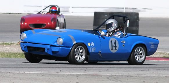

GT6Steve Posted July 2, 2008 Posted July 2, 2008 This is the result of dumping the front bumper. It works and I may do it on the yellow racer. Left hander than a quick right after the flatout banking at California Speedway ;D
