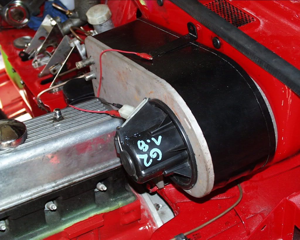

mk2vitesses Posted December 15, 2009 Author Posted December 15, 2009 I am very pleased with the airflow, cutting the hole was not fun, but now it's all installed and the switch wired it was worth the effort! http://i180.photobucket.com/albums/x119/mk2vitesses/PIC00016.jpg The cover is now powder coated black.
Nick Jones Posted December 15, 2009 Posted December 15, 2009 Ah, thanks for the switch link - mine still requires wire swapping under the bonnet to change speeds :B. Works alot better than the original but still pretty pathetic airflow compared to the Audi which practically pops the windows out on full power Nick
