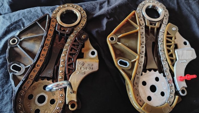

JumpingFrog Posted April 18, 2024 Author Posted April 18, 2024 I decided I couldn't take the stress and took it to a garage this week, I was meant to already be in the UK... Will have some serious driving to do next week. The garage (a reputable BMW specialist) promised they could get the chain, but they're having issues... Although they think now they finally have the right chain kit. They have confirmed that the chain guides they've removed are fubar and probably weren't long for this world. 2
JumpingFrog Posted April 26, 2024 Author Posted April 26, 2024 (edited) I got the car back from the garage as promised, and they even managed to fix all the oil leaks (valve cover gasket, high pressure fuel pump gasket and front main seal), but I'm not that happy with how they did the chain. They appear to have reused the crank pulley stretch bolt, and now the exhaust cam reference position is even further off time than it already was with the old stretched chain, almost at the maximum (+9.75 deg, of +/-10 deg maximum compensation). But nevertheless test drive through the centre of Moscow was very successful: So I set off, not wanting to waste time, I don't have much to report. Russia - Estonia border was very fast, under 4 hours, as expected Russian side checked everything, including flicking through books for hidden money, but Estonian side was completely hassle free. After that I just drove for 4 more days, 400+ miles everyday, car was more or less okay. Injector/emissions control system problem rears its ugly head in heavy traffic and the engine starts to misfire if running at low speeds for more than half an hour. But at last made it to England, with all my stuff, and a mostly working old 3 series. I have a lot of things to do now, like starting a new job, finding somewhere to live... Hopefully the BMW will behave itself until I can find time to fix everything on my list: Fit emissions NOx sensor emulator. Possibly change 1 or more injectors. Â Brake overhaul (front: pads, rear: calipers, hoses, pads, discs, hand brake shoes) Replace oil pump drive chain and inspect big end shells for damage. Reset timing, replace stretch bolts. Â Edited April 26, 2024 by JumpingFrog 3

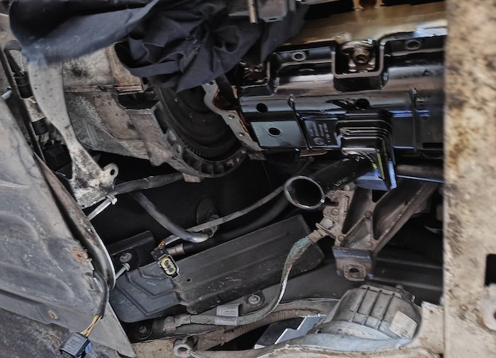

JumpingFrog Posted June 11, 2024 Author Posted June 11, 2024 In for a penny, in for a pound as they say, decided the only way to find out if 3000 miles with a blocked oil pickup did damage is to do the big end shells. First you suitably support the engine with the cheapest beam you can find: Then you drop the sub frame and remove 20 hard to reach sump bolts: Then you spend an hour chiseling at one of the very shallow torx bolts that holds the oil pickup on after its centre strips out... This reveals the balance shaft and oil pump assembly, more torx and e-torx later and you finally get access to the crank: So far only pulled one shell before I ran out of daylight and energy, to me condition seems so-so, maybe a little worn for only 92k: Cut the filter apart too, maybe total five small metallic pieces, but nothing that scary given what its been through (and oil hasn't been changed since new chain). Other jobs to do now include the thermostat, since it seems to have given up the ghost and engine coolant temp never gets over 70c which can't be good for economy. Plus some hoses are a bit ropey from when the valve cover gasket was leaking... I did the new injector, nothing much to report on that, it idles smooth now when hot but still hunts a bit for a smooth idle when cold. 3
JumpingFrog Posted June 13, 2024 Author Posted June 13, 2024 Well, considering I drove 3000 miles, with an oil pickup mostly blocked with plastic, the bearings are remarkably good. Even wear on every cylinder, crank like the day it left the factory... Replaced all with expensive Mahle shells (I believe made in England, basically Vandervell?), all came out at 0.05mm with plastigauge which is spot on (factory tolerance from 0.025 to 0.075). Doing this with the engine in is still not fun though, getting up to the 20NM + 120 degrees torque takes some doing and I'm finding the etorx big end bolts very susceptible to "cam out" when working upside down. 2
Nick Jones Posted June 13, 2024 Posted June 13, 2024 Those all look fair enough. Are you able to get at the mains in situ? Though problems seem unlikely given the BE condition. BMW do have a bit of a rep for bearing problems these days, especially on 6-pot M-cars. I don’t really understand why - bearing tech is well understood and stable. I guess boundaries of clearances/tolerances and oil viscosity are being run too fine. PS. You are being more patient with it than I would be!
JumpingFrog Posted June 14, 2024 Author Posted June 14, 2024 18 hours ago, Nick Jones said: Those all look fair enough. Are you able to get at the mains in situ? Though problems seem unlikely given the BE condition. I'm not confident enough to say for certain it's impossible to do the mains in situ, but it has a crankshaft cradle so it would at best be extremely difficult. From everything I've seen online, even when multiple big ends have spun due to low oil pressure, the mains will still be in good condition and I'm worried about upsetting it. Other than timing chain guide induced starvation, the run of the mill BMW engines don't really have issues with the bottom ends... On the subject of oil, had the fancy oil pump apart, mostly just to check for debris and out of curiosity: Alloy housing has minimal wear and no debris sitting inside, although there are some deep scratches on some of the vanes, I'm sure it'll be fine: 2
