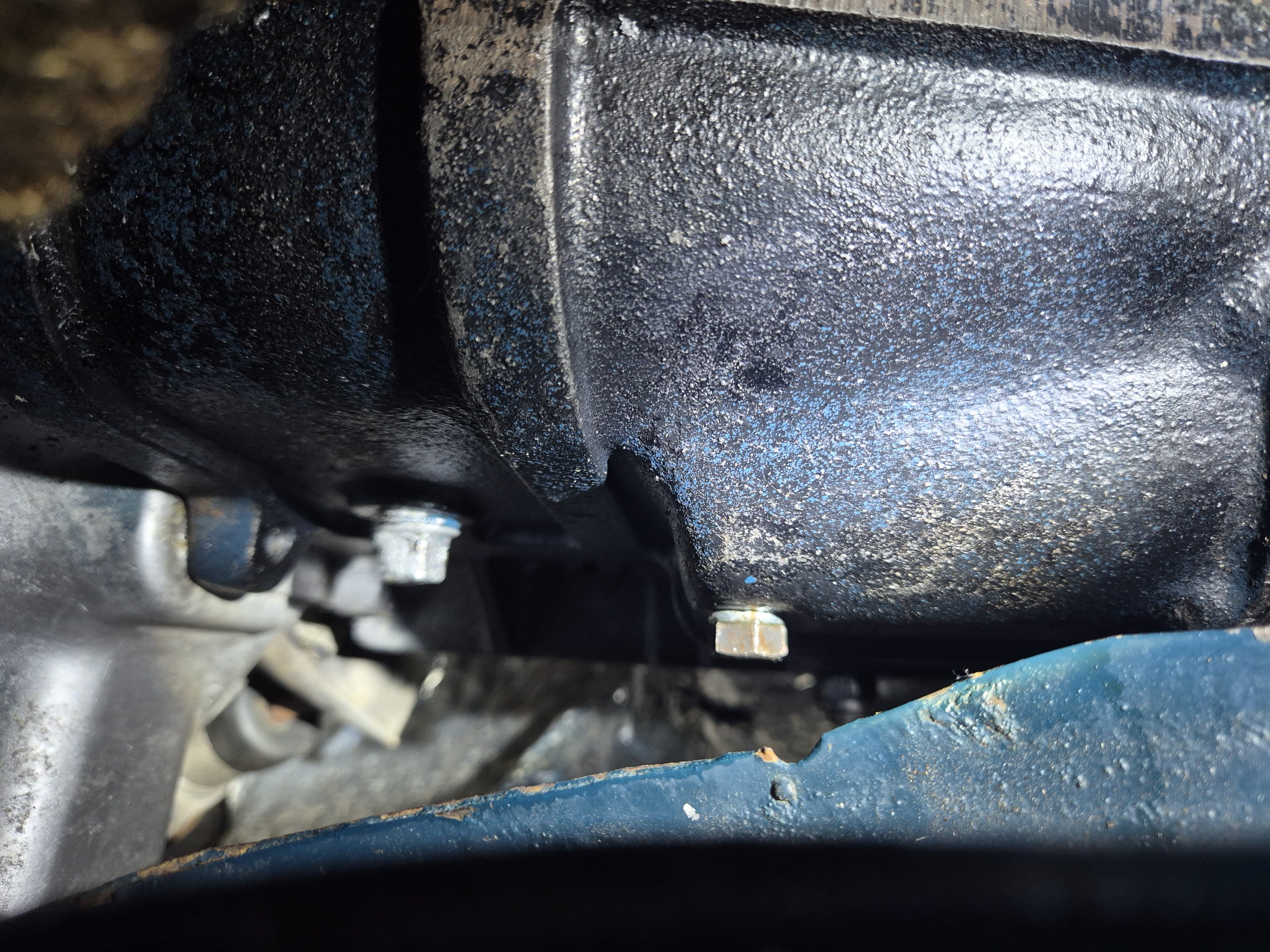

  1. Thanks chaps, exactly what I did, I did take it out completely(risky I know), cleaned the threads as Ecosse suggested, and sealed the hell out of the threads and face with ptfe and sealant as you and nick suggested... Now I haven't looked under the car yet, but 9/10 I can smell it as soon as it leaks, as it goes straight onto the exhaust... bone dry, no smell so far! I am very happy!
  2. thanks guys, im glad i left it for a few days and had anothe look, all good info to know for the threads, you all saved me a massive ass ache so thank you. its not completely clear, but i think i found the culprit, looks like the drain plug is dry, the only thing with a trace is the reverse shaft retaining bolt, its not that clear but everything was bone dry and now its nice and leaky. Quick Google shows im not the only one with a leak like this, which is nice. Now, taking it out is risky. So back it out enough and lash ptfe over it? Or gently take it out, ptfe and out back in. And yes I'm well aware I'll never get a leak free car, but the box leak with it going straight onto the exhaust is driving me crazy
  3. I might opt for the drain plug that most of the aftermarket suppliers sell, the magnetic type that has a copper washer and large hex head, ptfe tape, and the copper washer butted right up to the box should seal it, if its the leak, tonight I'm going to look under the car and really hope to see oil around the threads and on the bolt head, all cleaned last night. The thought of taking the tunnel out makes me sick so I know how you feel. Sadly no cardboard tunnel anymore either that had a handy flap cutout by the box fill plug. I just hope the threads aren't damaged.
  4. Well its been a while! Nearly 500 miles down and touch wood, no dramas, issues or woes Cars been a little neglected of late, past 2 weeks been sat outside on the drive, criminal I know, whilst I've been welding up a friend's mini. Few gremlins still to kill. Tailgate is still filling, so going to plug the holes at the topand drill a small drain hole maybe at the bottom for breathing once its dried out. Battery has bitten the dust too, tried my clever de sulphate charger, but no luck , my health checker says only 50% health, internal impedance at 6.3mohm, so not good. It lasted quite a while as I bought it 2019 I think, so not bad, the lack of use when the car was knackered didn't do it any good. Bought a replacement so one less issue! Still have a box leak. Great. However, I do think I have the culprit. After the 2 weeks sitting idle, started, and straight away smoked, theres a drop on the drain plug and misting around it, its the lowest point so it would collect there regardless. However, top of the box is bone dry, left side of the main case is bone dry, right side has some misting a little below a bolt head to the left of the fill plug, which could be a potential too, or just the air whisking it up. The drain plug has always been a pain, its a magnetic one but one with a tapered thread. Two minds now, clean it all off again, wait a few days and if it is the drain plug, I'll get a collection of oil on the bottom of it only, if its anywhere else ill see a smear. It'll be off to Lymington for a cars n coffee morning on Saturday organised by a friend to raise money for the RNLI so should be a nice drive! On the return It'll be about 600 miles done, so we'll worth dropping the oil, changing the filter, checking the head bolt torque, valve clearances etc, normal post run in checks.
  5. This is true, if it had leaked it all out, id have had nothing come out when I took the fill plug off. Typical ill chuck it all back together.
  6. Well, one problem solved, another disappeared. All electrical issues solved! Box. Well it has a ghost leak. Drove the car with the tunnel off, my god the heat, and is a bit sketchy watching the road. Not a drip. Let it cool overnight, started, warmed up in the garage, drove, nothing. I know what will happen, the second I start it after putting all the trim back in, it'll come back. Oh well.
  7. New alternator fitted, and running fine! Had to do a few idle tweeks but otherwise all good! Had it sitting steady for about 10 minutes no issues. This is good. The only other thing is the rpm drops when the lights go on, this engine really doesn't like idling below 900, probably the cam and setup, headlights do drop it a bit to the point I need to topup the rpm a bit. I will test the battery too as it is quite old now. I know the drop is normal, but I'd just like it all to work nicely The pain in the arse bit. Cleaned the oil off around the box, ran it. Bone dry. Bone bloody dry. Not happy. ive watched it from cold drip slowly onto the exhaust. Very annoying. I checked the level and had a little start weeping out when I took the fill plug out, so its not low. Need to drive it with the cover off and let it cool, then restart and hope to see it
  8. Update, managed to get the tunnell out and have a look around, definitely higher up, thank god. I have to go out again so will run ot when im back and observe where its coming from. I also have a spare selector housing gasket so might just pop it off and deal with it all on the bench once the leak is found. Alternator had also arrived! One last arse ache and we should be trouble free
