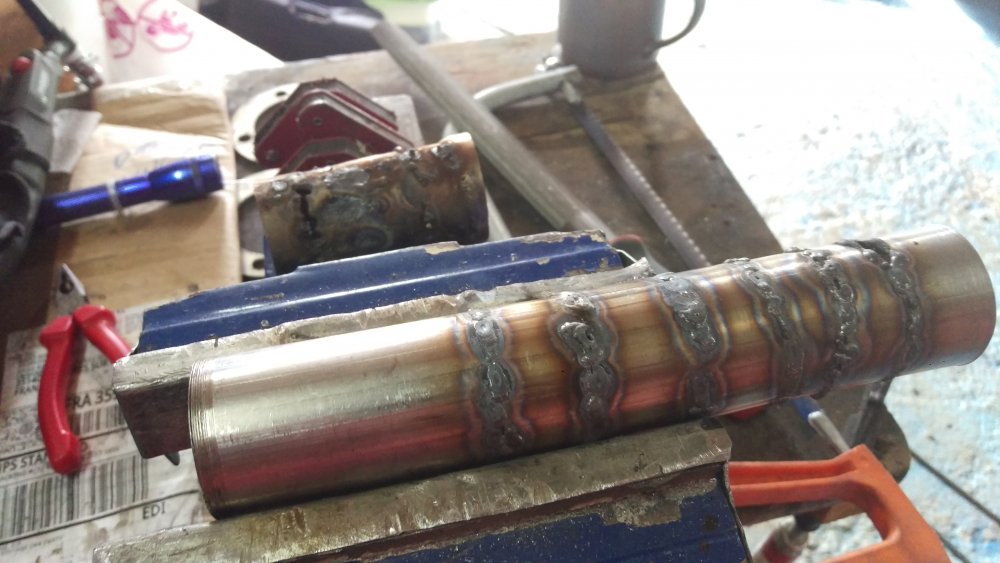

RedRooster Posted December 4, 2020 Share Posted December 4, 2020 On 11/27/2020 at 6:16 PM, RedRooster said: Just need to make a few more now. Link to post Share on other sites
Nick Jones Posted December 4, 2020 Share Posted December 4, 2020 I had a "WTF" moment...then I looked back to your post of the 27th and all was clear. Looks labour intensive! Link to post Share on other sites
