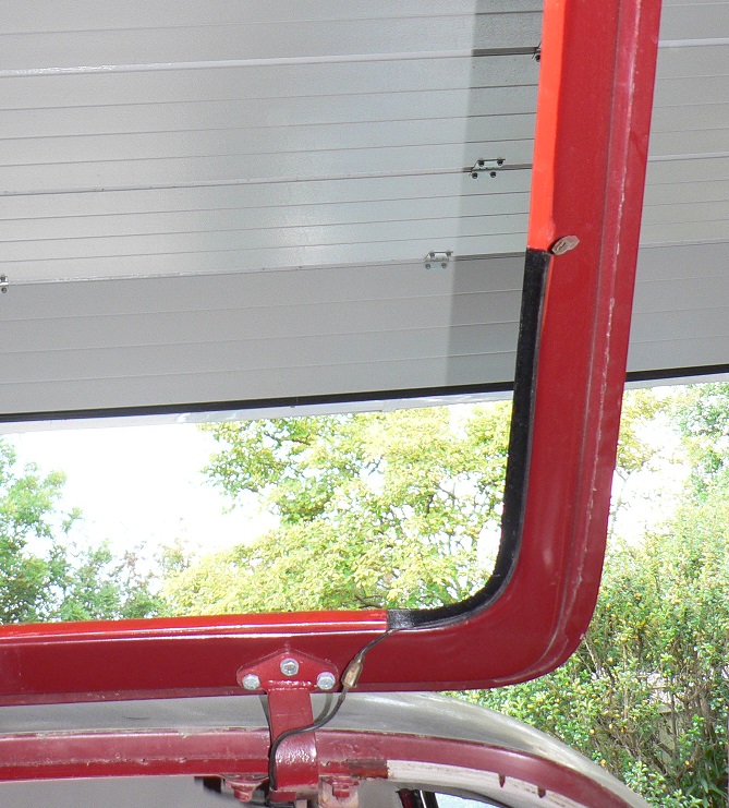

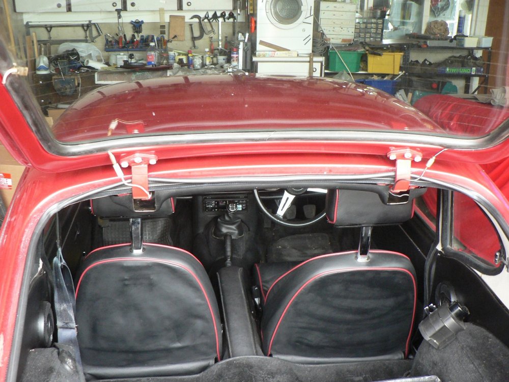

Hi,
Just joined the forum so this response is a little late as well- noticing the date of the original postl:ermm: However this might be useful for future reference if anyone searches on the subject.
On my MkIII GT6 there are two short wires (female to female spade connectors if I remember correctly) that connect from the loom at the tailgate hinges to the spade connectors soldered to the heating elements on the window.  These wires are taped to the flange in the tailgate recess and run along the corner of the recess from the window connection emerging by the hinge.  When the window is fitted they are hidden by the rubber moulding.
Hopefully the photos attached make sense of the above.
